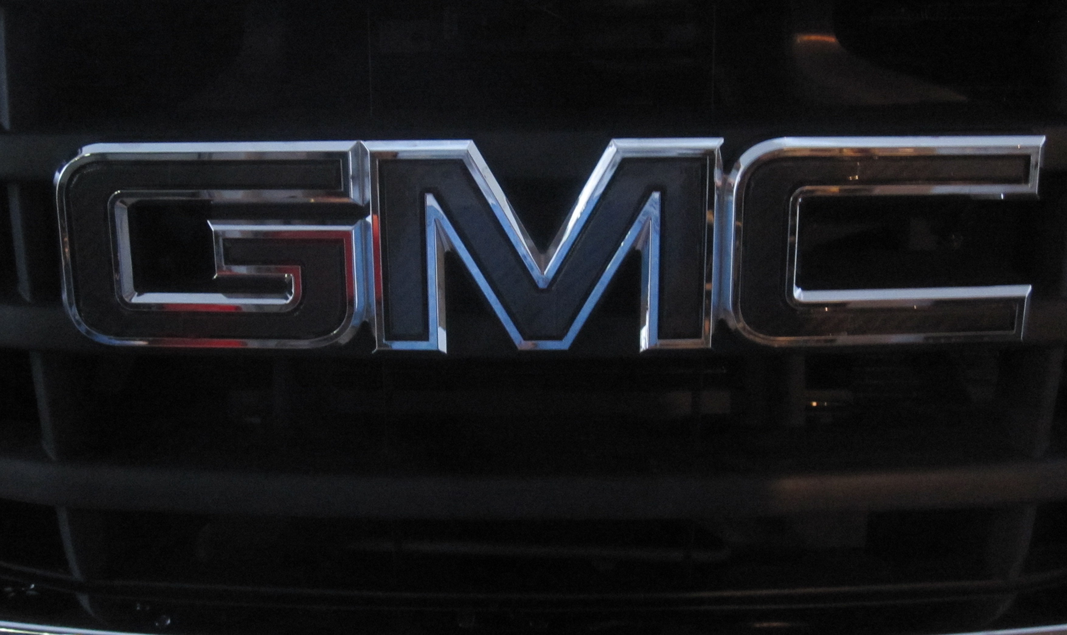

I bought some "carbon fiber" :rolleyes: vinyl at Pepboys one day just to see if I could do it myself. I taped it over, cut it out with a razor and kind of curled the edges over into the creases with a heat gun real quick. Actually came out great and hasn't peeled at all through a winter and countless car washes.
Thats the anwer I'm looking for right there! Because I own a GMC that is.
