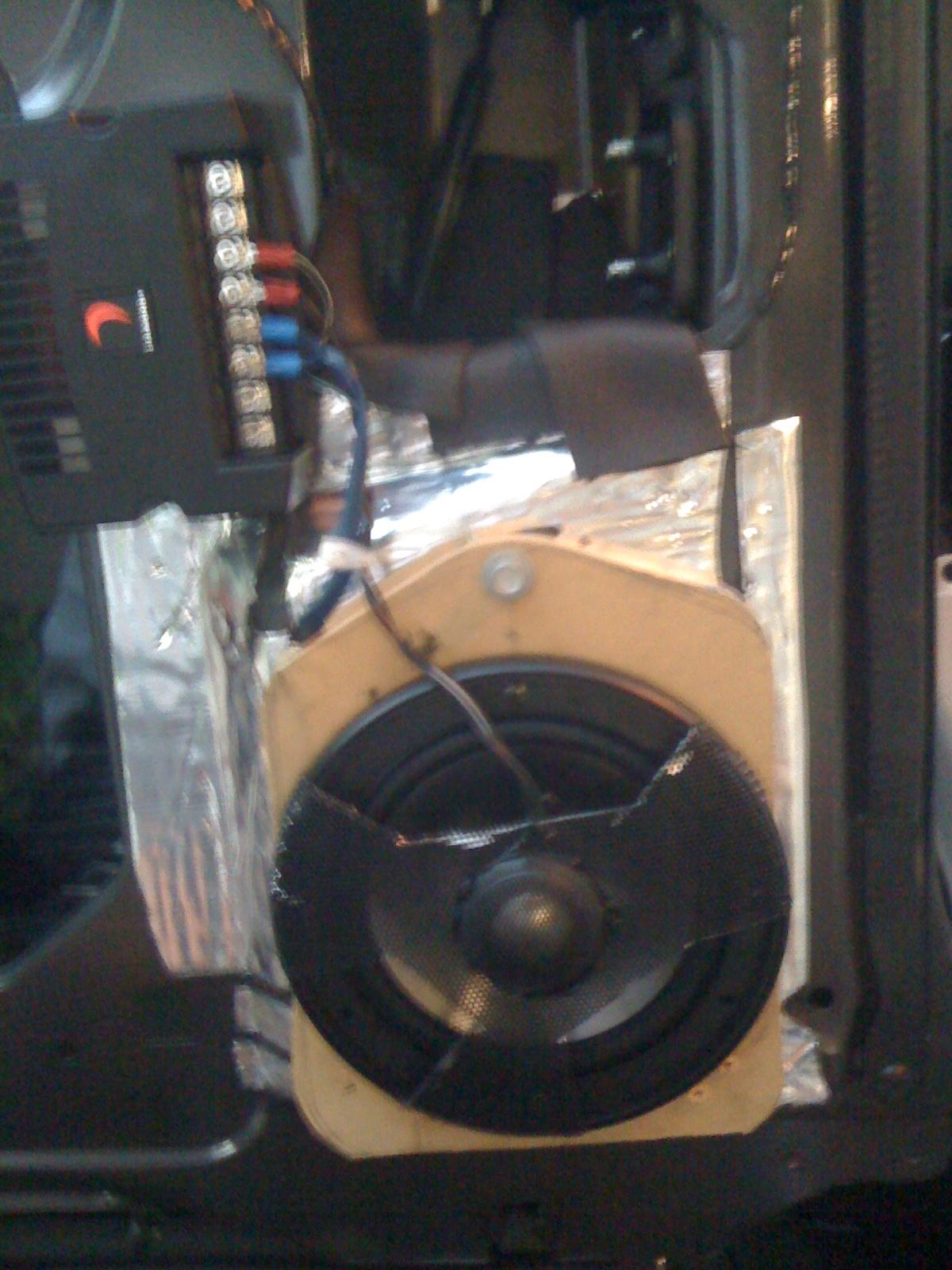

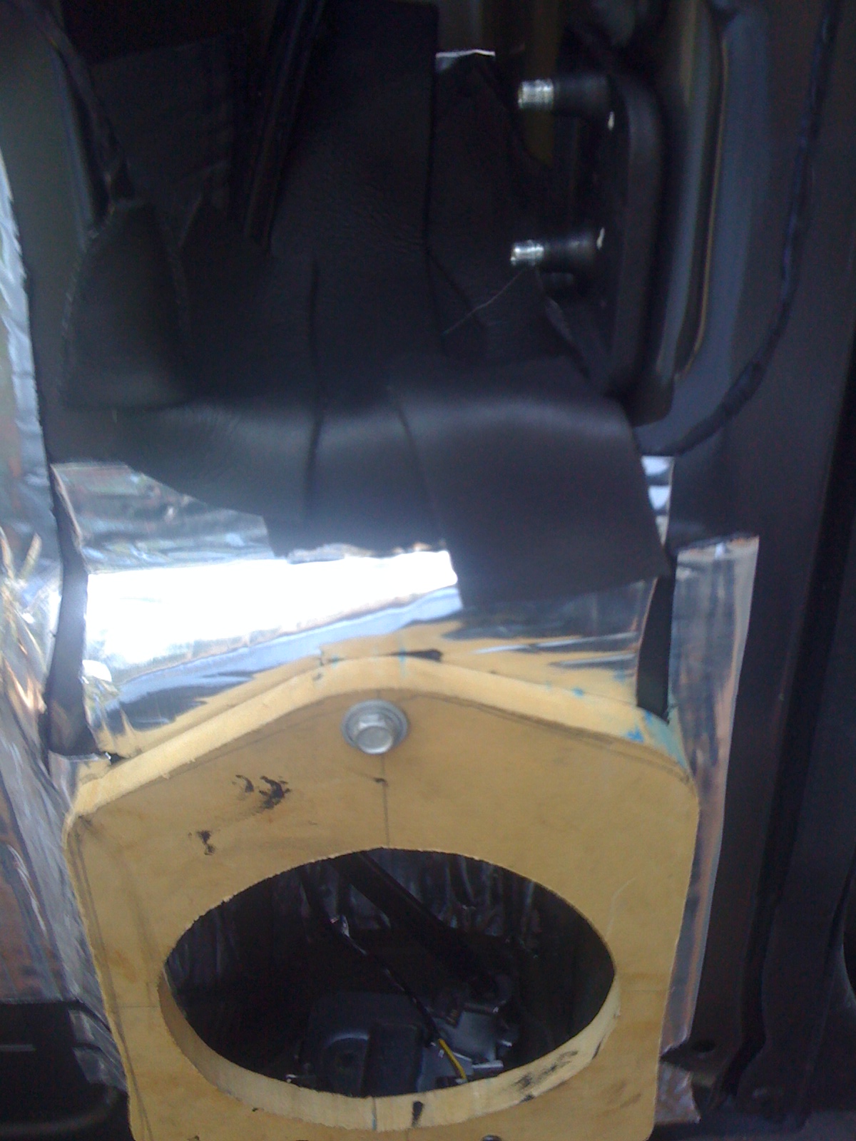

got the rear doors done. made a speaker plate and mounted the tweeters in the aftermarket grill. added lots of sound deadener (B-Quiet)
and sealed off the speaker pocket with foam tape.

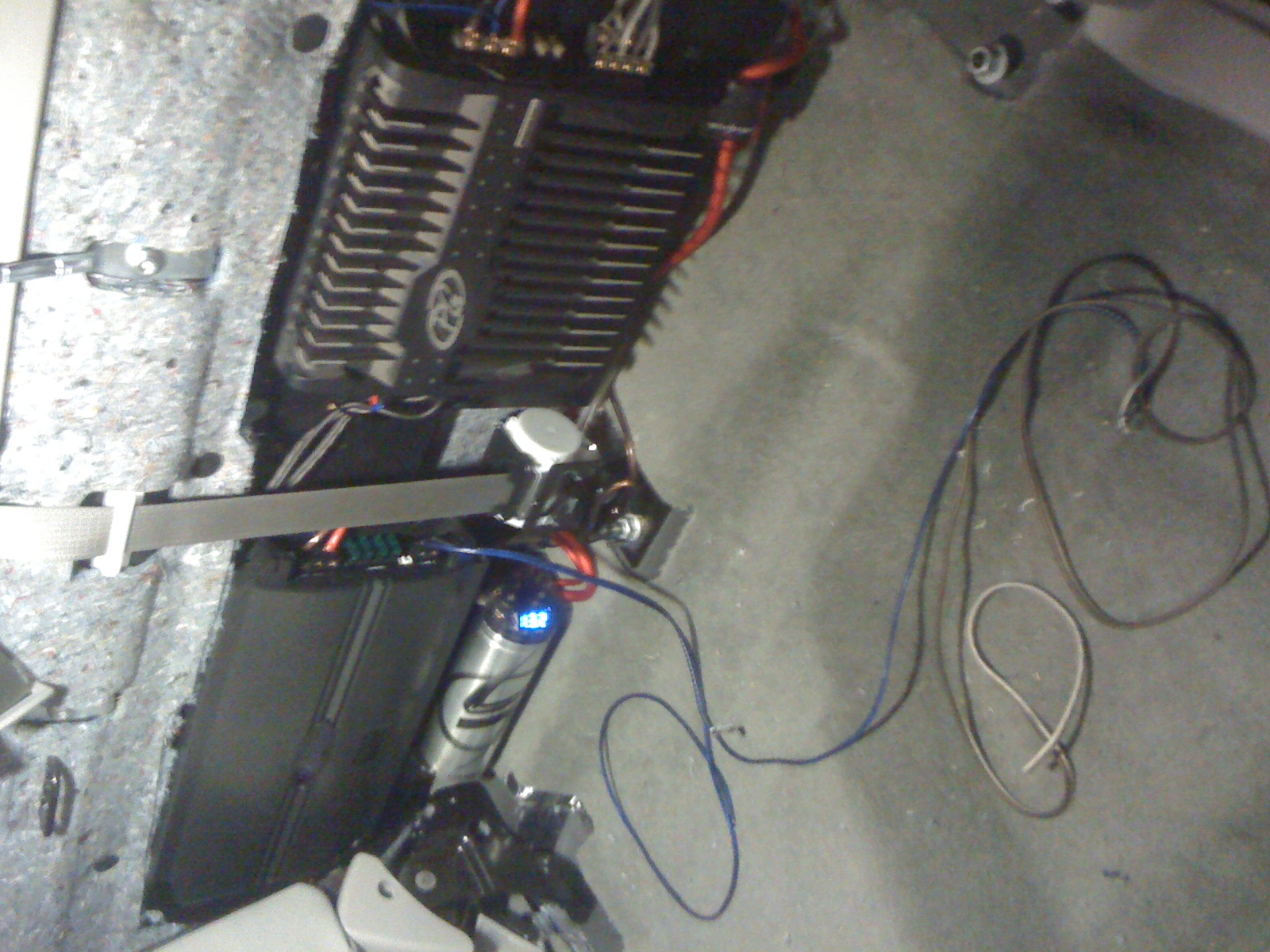

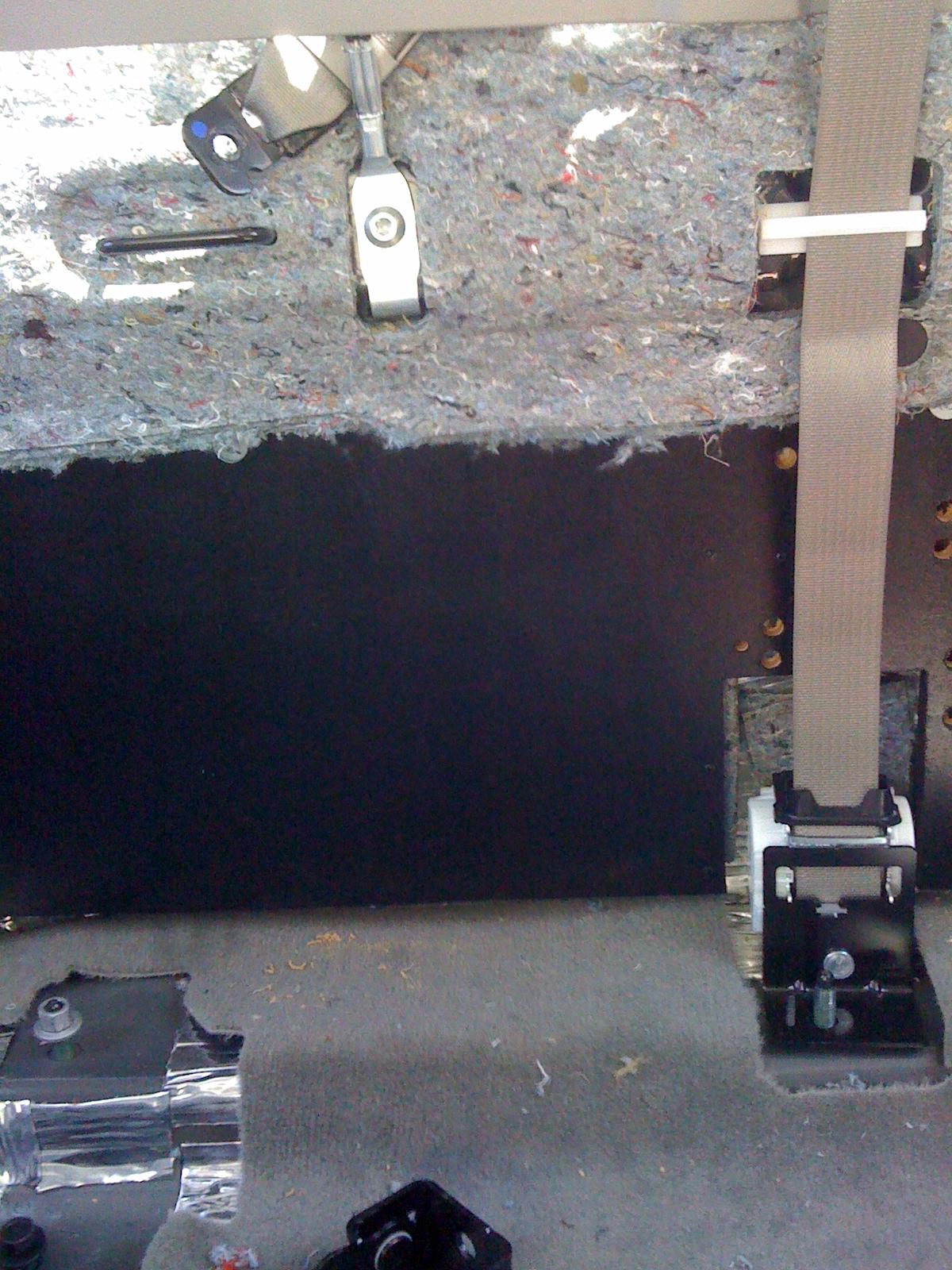

made an amp mount for the rear wall. put the B-quiet accross the back and under the rear floor carpet.

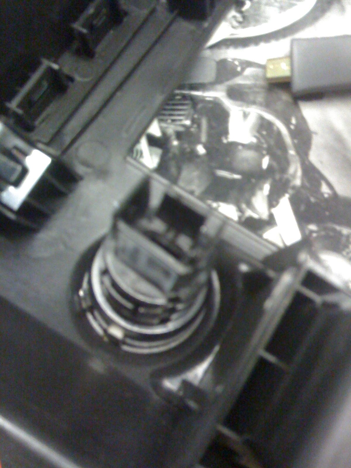

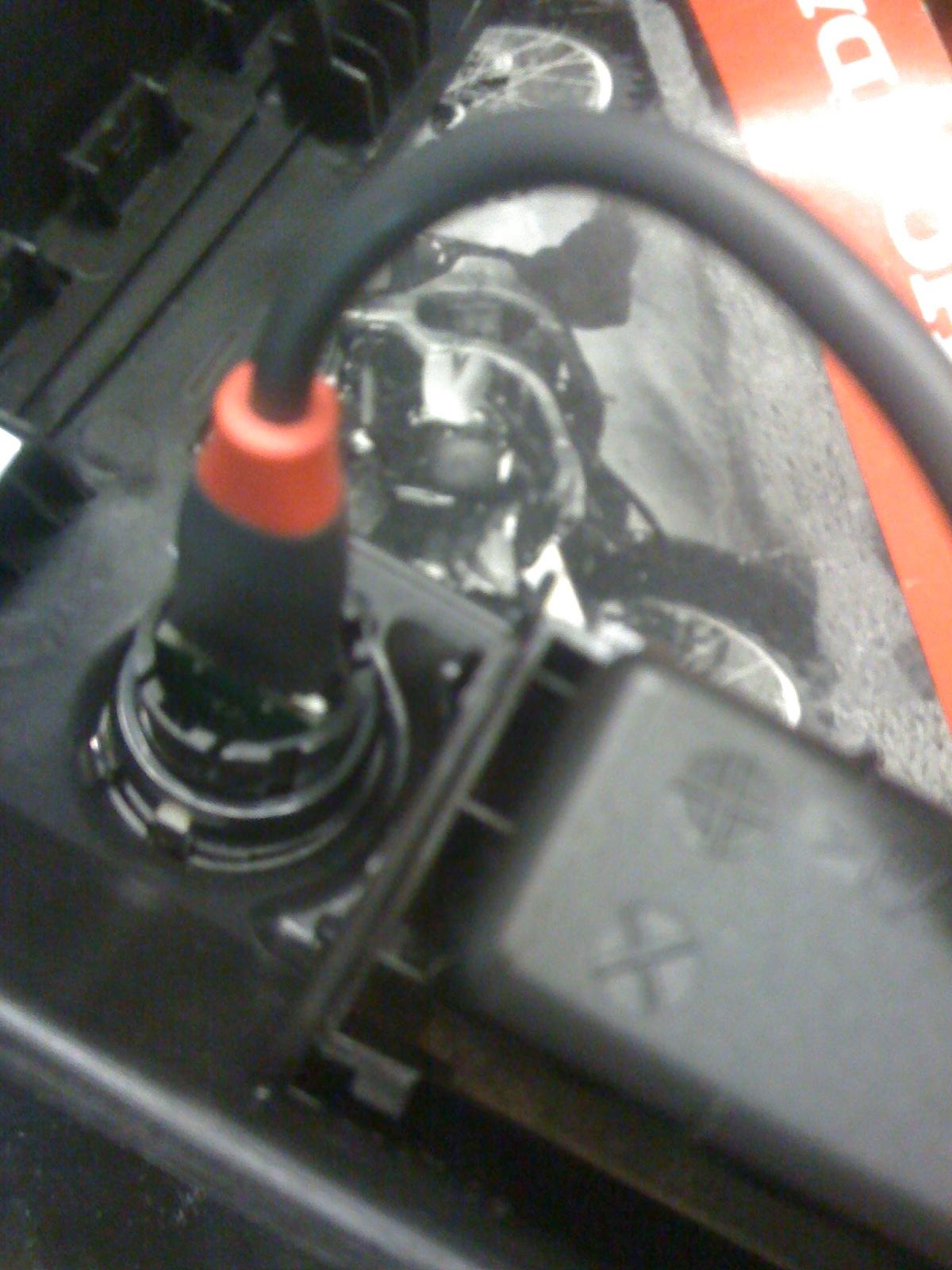

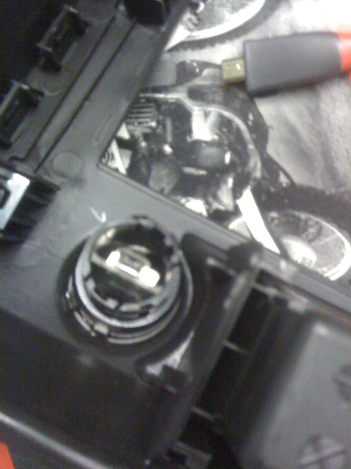

I also figured out how to keep the stock USB port on the dash. Used a mini USB to USB adapter cable ,Removed the back of the connector and pluged it in,simple.
where you going to ground your amp to? Seatbelt bolt or have you found something better?
I scraped the paint from the floor and seat belt top and bottom then bolted the ground on top of the center belt. No noise.

The cable I used for the USB adapter didnt work. The USB only works if you use the Alpine cables (WTF?)
I didnt even need it . Blue tooth audio wirelessly transmits my music from my Iphone no cables needed. But it sounds better with the cable. Then I found out that I could get a High speed ipod cable that plugs in to the blue tooth module for faster searching and such. $10 off ebay.(on order) so the usb is obsolete.

How did you attach your amp board to the back wall?
Are you running tweeters in the back or just up front and are you amping them ?
Are you using one amp for all the door speakers?
Im running Diamond audio D3 components speakers in the rear. (woofer and Tweeter with external crossover) see pic in first post
Im running Diamond audio D6 components in the front . Powered by a 400 watt 4 chanel Phoenix Gold amp.

I attched the amp board with 4 short screws at the top so they would not penatrate the back wall , only the lip from the sheet metal that hangs down. I also glued it to the back wall that is covered with sound deadener with Liquid Nails. Seems to be rock solid.
