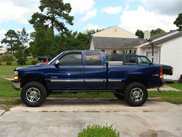

Hi. I have a 2002 chevy Z71 with a 6" procomp lift. I need 1 more inch of lift because my 35" tires rub just alittle when i turn and back up. My torsion bars are all the way up now and have been for 5 years with no problems. Can i use torsion keys to lift the front 1 more inch with the 6" lift togather?

no. if your torsion bars are cranked all the way already you are maxed out on that method.
if you already have 6" of suspension lift, why not add a small body lift like mentioned above?
Keys will allow you to go a tad higher, but that "5 years with no problems" will come to an end. Cranking the stock keys to the max already puts a extra stress on the suspension parts, any higher and it won't be good for the truck, your wallet, and your safety. Like mentioned, I would look into de-cranking, then adding a 3" body lift, or leave the keys where they are and adding a 1.5" body lift.
Nice truck man. I've got a 2.5" level and a 3" body lift myself. It scrubs exactly like yours does. The 1.5" BL should solve your problems.
