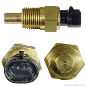

GMhunter93 Posted October 21, 2010 Author Posted October 21, 2010 I think it actually may be a TBI by the looks of those pictures. Where can I find the Coolant Temperature sensor? That sounds like a very possible problem.
txab Posted October 21, 2010 Posted October 21, 2010 Many times it's in the cylinder head on the passenger side, might be on driver's side. Some vehicles had them in the intake near the thermostat. If you still have a TBI then you have an O2 sensor. It will need to be checked and maybe replaced.
GMhunter93 Posted October 21, 2010 Author Posted October 21, 2010 So it is probly mounted over the passenger side cylinder head?
txab Posted October 21, 2010 Posted October 21, 2010 Some vehicles had two temperature sensors/senders. One for the guage, one for the computer. If it does have two, usually the one near the thermostat housing is the computer sensor. If there is one in the head it will be on the exhaust manifold side of the head. Part might look like this: Sensor Sender I'm not that familiar with the mid to late 90's 5.7 and their layout. Trying to go off memory
GMhunter93 Posted October 21, 2010 Author Posted October 21, 2010 Thank you so much , I think I know were it is now. So how does one of these things go for?
