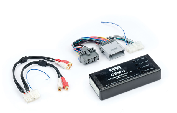

I have done a ton of research on this and I think I have finally figured it out, maybe? In order to get my stereo out plugs for my amp I plan on buying the PAC AOEM-GM24. It is an interface that plugs into the factory head unit to give me the RCA outs.
I understand that plugging it in behind the head unit should give me a clean signal that is unprocessed by the bose amp. So far I think this setup is supposed to work pretty good. I have heard that the bose system will sometimes decrease the amount of bass as the volume is turned up to prevent damage. But I think taking the clean signal from the headunit will solve that problem. Also, I think the bose subwoofer will still be working and everything should be easily reverseable incase something was not right. Correct me if I am wrong in any of that?

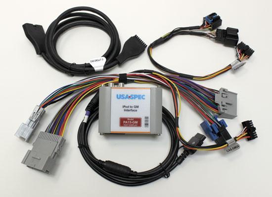

But here is my main question, I have a USA Spec PA-15GM Ipod interface. It is plugged into the bose head unit and works great.
Do you think it will work to have both interfaces connected to the bose system? I mean the plugs should all match up and have no problems there. But I have the USA spec Ipod interface and also need to add the PAC interface to give me the RCA line outs for the amp/sub. I am just really wanting to know because I don't want to invest in a bunch of equipment and start an install just to find out I have major problems. Any thoughts would be greatly appreciated. Also, which one should be connected first. Bose+Ipod interface+PAC interface? Or Bose+pac interface+Ipod interface?

The OEM-1 shouldn't cause any conflict with the PA-15GM, but I would connect the OEM-1 harness behind the PA-15GM harness, starting from the radio.
However, I think the OEM-1 might not might not work for you because the output from the radio to the Bose amp is already low level. Can you buy that harness separate without the converter? Then you could just splice the RCA jacks onto the wiring and not have to modify or tap into factory wiring.
Thanks for the reply I also just got a reply email from PAC saying that it PAC AOEM-GM24should work with the pa15 because it is a pass though design. But what do you mean without the converter? I included the link if you need to look at it. I don't see anything about it converting to low level. I just put in my truck and it pulls this up as a compatible product and says it is design to allow adding a new amp to factory premium sound systems. I think it also has level and gain contols on it. When I put in my truck on the website this is the only one that pulls up to work with my truck for this type of application. But I know you can find older ones and different one that splice on amazon and stuff. Let me know though if I am missing something about this level converting? Cause I though it was just a box to give me RCA outputs?
Thanks
Sorry I missed this earlier. My concern was that because the output from the headunit to the Bose amp is already low-level, using a line-output-converter would make the output to the aftermarket amp extremely low.
However I looked at the instruction manual for the OEM1, it's a little vague but it sounds like it is compatible with low-level input, so you should be okay.
