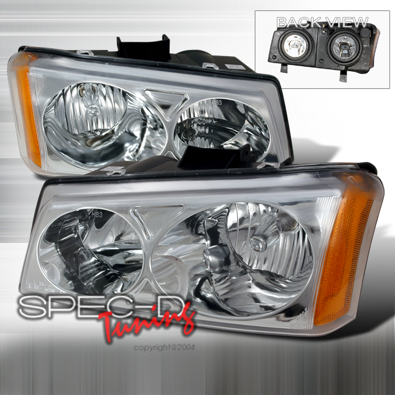

Quick question everyone. I seen a topic the other day on here about HID's and the use of Projector headlights to properly spread the light for oncoming drivers so did a quick internet search and come onto these Headlights. They seem reasonable and I like how they look pretty much stock as well. Are these 'Projectors' and would these work nicely for HID's in the low beams?
http://www.andysautosport.com/chevrolet/19...cd00010094.html
Link for Spec-D Tuning's Website: http://www.specdtuning.com/2lh-siv03-ks.html
Looks like you can also get a kit with all four front headlights, but assume this is just so the headlights all would match each other, and I can't find the link or website of the place that carried them at the moment but will keep looking.
If these would work for HID's I would consider them, and then I wonder since they are "Legal in all 50 states" if they are aimed right, they would be legal correct? Thanks for the help in advance, I don't know to much about these!
looks like a halogen to me. the best way to tell is by looking at the eye so the speak. a projector looks like this
but you gotta make sure you get something with an hid projector, as a halogen projector will work even worse than a non projector halogen housing.
Those are projector lenses and better than just reflectors I guess. However I've yet to see an aftermarket projector housing meant to house an HID setup. Everyone I've seen is meant for a halogen bulb. If you put an HID bulb in, you change the optics or the projector, sort of like changing a prescription on a pair of glasses. Unfortunately, the only way I've found to put a projector in vehicle that didn't come that way from the factory is to retrofit one in.

Thanks for the reply. To bad they wouldn't work out well for HID's. It was on that pages 'projectors' but from what i read on here, they are expensive so didn't figure they were. Thanks!
