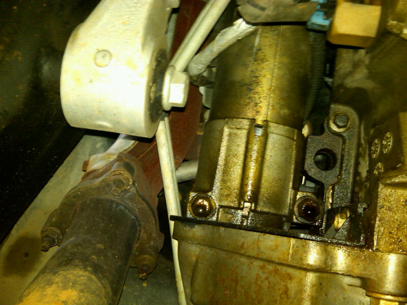

Oil Leak
Yep....looks like your starter bolts have started to leak. :rollin:
Travis
Does the 2001's have the crank position sensor above the starter like the newer ones do.
I know on the GMT900's, oil leaking on the starter bolts is usually coming from the CPS above it.
I've got a '99 on the hoist right now and yep, sure enough the CPS is there above the starter.
Travis
What's all involved in changing this CPS out if that is where its leaking from ? Is it something that should be left up to a shop ? How much do these run in price ?
