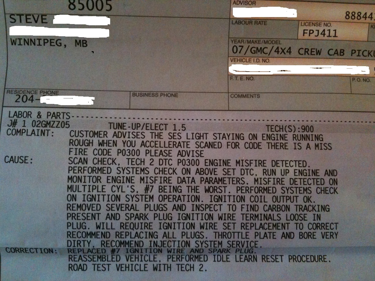

Yesterday My 07 5.3 sierra Lite up like a christmas tree . Every warning that can come on was on Truck had no power Traction control and Stabilty Track service engine , Factory alarm lite .Truck ran like crap......Got it to the dealership Service tech asked if i pluged in the truck the other night ..... I told him of course it was dam cold lastnite ... He says the blockheater cord has a sensor on it and that they have knowen problems with them ,He then gose gets a tech2 Hh and gets 2 code's P0300 and 1 other dont remeber the code he said ..... So he clears the codes , starts the sierra and says sounds better now then when it came in ....He says take it and let me know how it is . Well i drive out the parking lot and all hell breaks lose on the truck .All lights on dash lite up truck stalls , after 2 mins of cranking it start's ,Turn the truck around take it back inside dealership... Tech again comes up to me says what happen thiss time the warning lights are still on inside the truck Say to leave the truck and they would check out what is going on ...... I told them right there i would not be happy with another $800.00 bill as it cost me $782.00
two weeks ago. Well i get a call 4 hr's later them saying all my plugs and wires need to be replaced .....For the Sum or $728.00.... I tell him how the H Double hockey sticks can the plugs be bad . they were just replaced 5 weeks ago . He then says the plugs are carbon up bad and the wire's are arcing out ... I tell him noway i am paying $700.00 for plugs and wire's . And for them to put the truck outside .... he says Steve we cant just put it outside you need to changed #7 plug and wire forsure before the truck will run ... So i tell them put a plug and wire on it then ... And head over to get the truck ...............$483.11 to get the truck out of there
Parts $123.90 for a spark plug and wire
Miss chrg $10.00
Labor $297.45 Tax $51.76
Total $483.11

The sale's tax is high as i live in Canada....Here is a copy of the Bill . I did make a stink at the dealership for this .. But to them its just another person pissed off for repair's done .. I have 40km left on the power train But told them at the stealership they would never see my truck here again . As for buying another truck that would not happen there also. And to take my name off there waiting list for my diesel along with my father's Name as i would be talking to him later today
Dont get me wrong i love my truck . and would prolly pay whatever it takes to have my baby run right .. But i hate being taken in by there crap and over price
I call bullshit on the repairs to your truck........... (not how much it cost but what the tech did to allegedly repair it).
I hate to say it but $100 says that wasn't your problem.

as I see it you are being charged for about 2.5 to 3 hrs diagnostic and parts installation time plus the parts with a big markup (yes, for all of you parts cost a LOT MORE in Canada...) plus misc service charge plus taxes
it is high for what you got ... but the worst thing would be if the truck still ran like crap after all this ....
my independent mechanic will do a lot of diagnostic work before charging ... but when he does charge for his work always seems expensive and it always fixes the problem ....
it sounds like you need to figure why there is so much carbon buildup in that engine, and to get the current accumulated crap out of there .... you have an '07 5.3 AFM engine, so are you consuming a lot of oil between oil changes...???? ... what condition are your rings and lifters in...?
