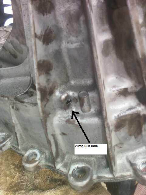

I had the same type of noise and it was the T-case. I have a 03' 2500hd with the 6.6 with the allison. What i found on the net is the 246,261 and 263 T-case have a pump rub problem due to the fact that the case is made of Magnesium and the pump is made of Alum. climb under the truck and look for a small hole next to the webbing where the tail shaft starts( about 2 inches from the parting line of the case) I have included a pic of what mine looked like. and if you don't see any hole take a couple pieces of long rubber hose and attached it to the vent tube of the trans, and T-case and Diffs. and run them up in the truck and drive down the road listening to each and that may helped find the problem. Also I got all my parts from High Gear they are the cheapest I found :thumbs:

I assume it's OK to still drive the truck with this noise, it's just annoying.
well I drove mine for about 100 miles or so. That way I would not have to pay for a tow bill. Well it has costed me bout 700 so far. Don't know how long it will last? If there is isn't any fluid in it for sure.
