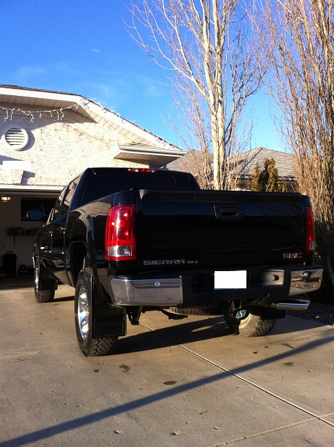

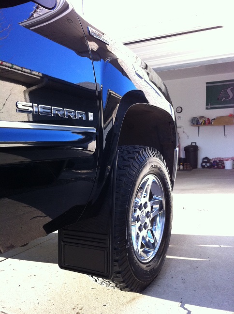

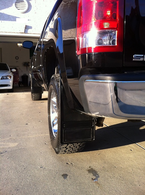

after taking off the molded GM mudflaps, I went with no flaps for a while but found that I was getting too many rock chips and the truck was getting too dirty.
I bought some all black (no chrome) croc mudflaps for the front and the back, and they look awesome.
pics to come

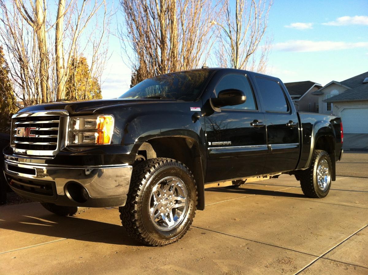

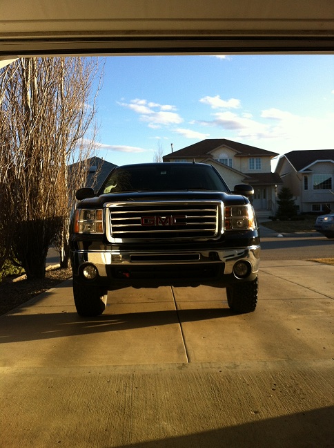

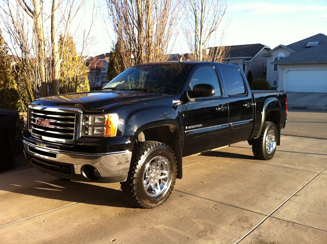

Tires are on, here are the new fender heights:
FL 40.25"
FR 40.5"
RL 41.5"
RR 41.75"
I got an extra inch of height with the new tires
so from what i can calculate my truck now sits about 4.25" higher than stock. not bad for only spending around $350. approx $170 on BL, $60 on level, $120 on rear blocks, and i sold my stock rear blocks for $80, so it cost me around $270 not including the new tires.
i will get some new photos up when the weather cooperates and i can also show the new blacked out mud flaps.
looks great. My truck sits a little lower on the driver side too...about 1/2 inch. Imagine it's cus the full fuel tank. It's enough to notice if you're looking for it.

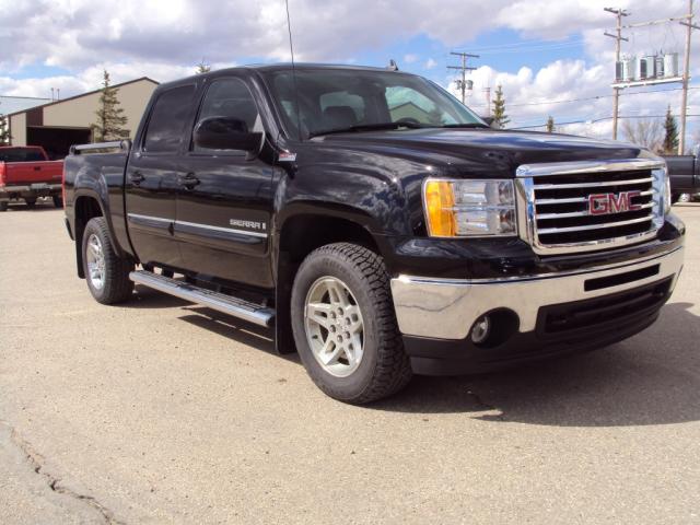

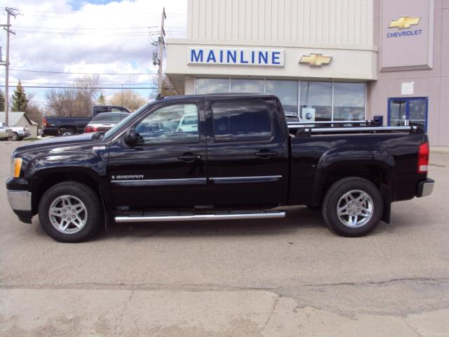

old vs new
yeah the sag on the drivers side is because of the fuel tank. i can only notice it if im looking from the back
i think i am pretty happy with it thus far. i may get some side steps as my wife is having a tough time getting in :)

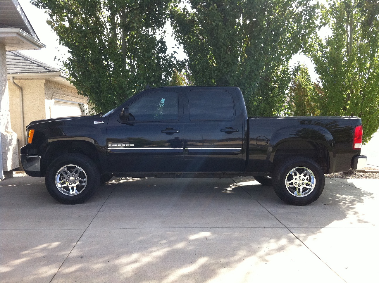

I just installed the Bilstein 5100 adjusting shocks on the front, set at 0.50" as i still have the RC 2" level on. Now i have 2.5" of liftin the front, and 1.75" in the rear, with 1.25" body lift all around.
ground to fender heights:
Front 40.75"
Rear 41.75"
I have also tuned with Superchips Cortex 2950 (awesome),installed a cat back dynomax system with VT muffler (which is great), weathertech front and rear digital fit floor mats and N-fab wheel to wheel side steps.
​Perfect rake and height. Ill post pictures when i get a chance.
