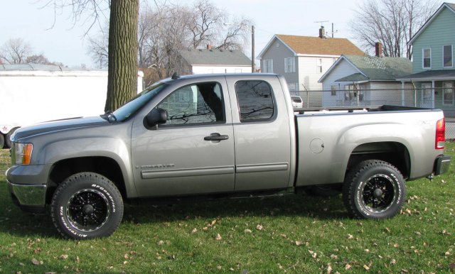

Nice! my truck is identical except for the differences between a '07 and a '09.
Sweet! Can you post a few pics of your truck? I want to see how she looks with those rims and tires! :lol::P
Sweet! Can you post a few pics of your truck? I want to see how she looks with those rims and tires! :):)
post-83566-1300806309_thumb.jpgI'll try
Hey it's my truck with nice rims and tires!! :lol: I like it! Looks great!
