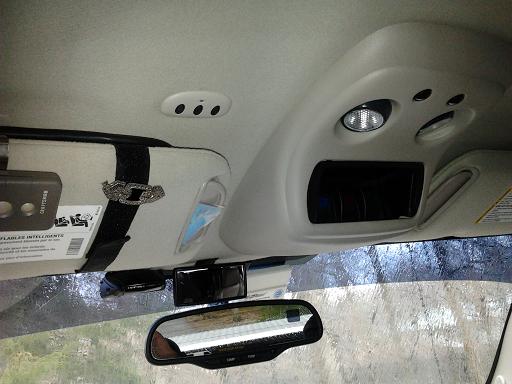

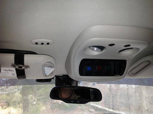

Figured I'd share a couple of pics of my latest mod. Been looking for an easy solution to the fact that I don't garage door opener remotes for both garage doors. I really didn;t want to pay $40+ for a stupid universal remote with 2 buttons. Every other car in the driveway has homelink so I was the odd man out. This got me thinking... Maybe I could install homelink, so I did some searching. Homelink modules that mount in the visor or headliner are realily available on used eBay (who knew) :lol:
So here's what i did. (You'll notice i got a module that isn't rolling code, but I didn;t care cause the price/color were right and my garage doors use the dip switches) So I jumped on it.
Here's a couple of pics (enjoy) :uhoh:

I bought the overhead console for the Tahoe that didn't have the sunroof. It comes with Homelink buttons. I took the rear AC controls out of the new console and put my pocket back in. A little wiring and I had a factory looking and working homelink setup. I needed to run a wire for the illumination portion of the buttons. That was the only part I had trouble with figuring out but I connected a wire to the brake module illumination wire since my brake module didn't use it. The 3 buttons light up when the headlights are on and work as designed.

Hey Rob -
Sorry, I guess I should have tracked this thread when I first posted it up. I answered your PM this morning but just so everyone else knows...
Did you have any issues with the Homelink mounted right up against the roof?
* I found there's alot of room up there, but I needed to put a smal piece of hard material ( I used a small piece of 1"x3" pine I had lying around to push the module against so it didnt feel flimsy. Nice and easy, no muss no fuss.
Did you have to remove some material from the roof's interior panel?
* Yes, the headliner was way to thick, so I had to trim some of the excess insulating material off the inside of the headliner in order to allow the module to sandwich with the homelink trim plate.

Just do a search on ebay for homelink, what you'll need to know is whether you not you need a code jumping homelink (google for info on this). Code jumping modules are a little more, but as compared to a new stand alone remote its a steal. The modules come with a simple 2 wire hook up, I wired mine to ACC so somebody couldn't easily break my window and open the garage doors while I'm not home... But you can do what ever you want....
Hope this helps!
