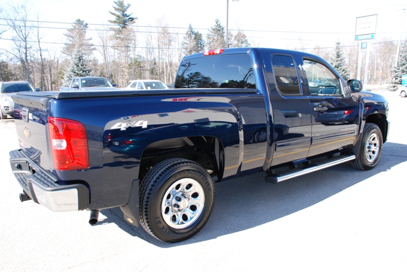

You bring interesting numbers. I just bought a new 4X4 2011 Silverado with 4.8L & 3.42 rear axle, and locked differential.
I tow an 18 boat which weighs approximately 3300lbs. I'd say 4500lbs loaded with gas & equipment. However, I bought the truck and the boat is still in storage. I'm sure you can understand that I can't wait to tow my boat and see the difference from the Blazer (4X4 4.3L) that I used to have.
I'm looking forward to see whether the transmission will be downshifting often. If it does, I'll just do like my Blazer and leave it in 3rd gear.
