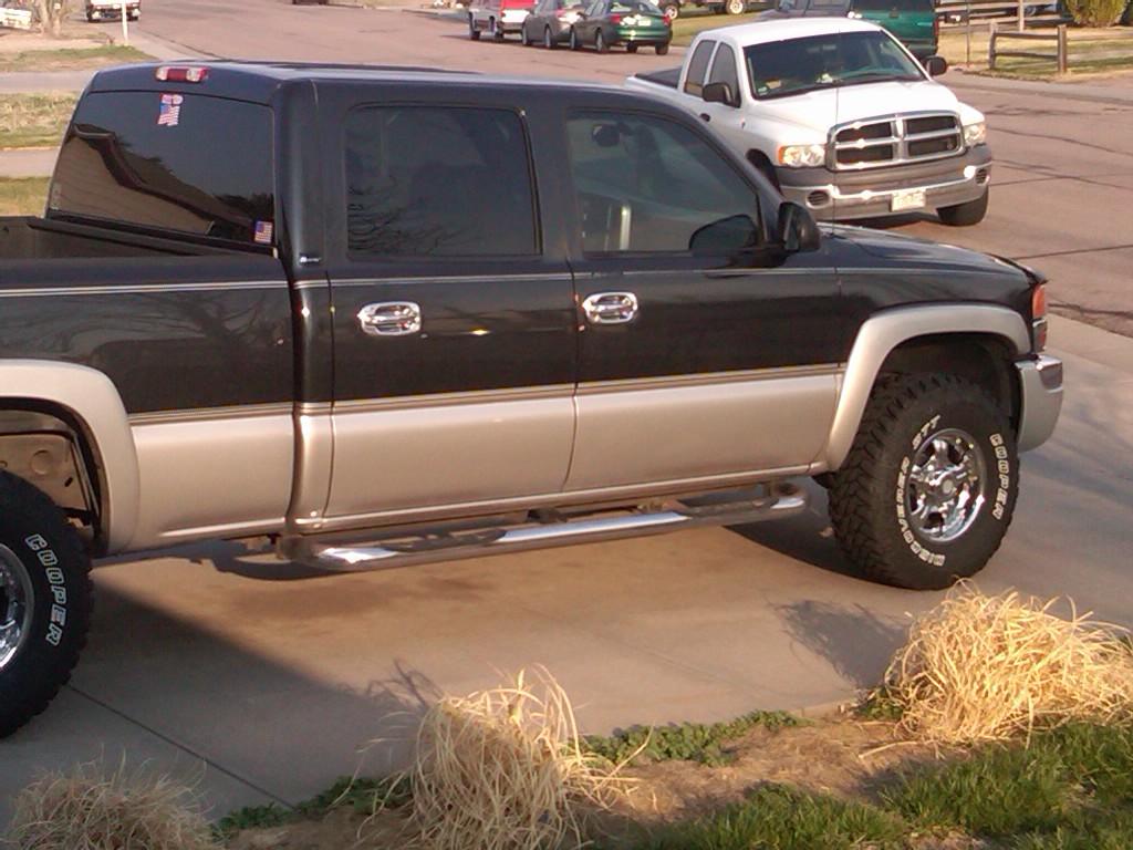

    • Black bumper and the later years Z-71 style color matched grille.
