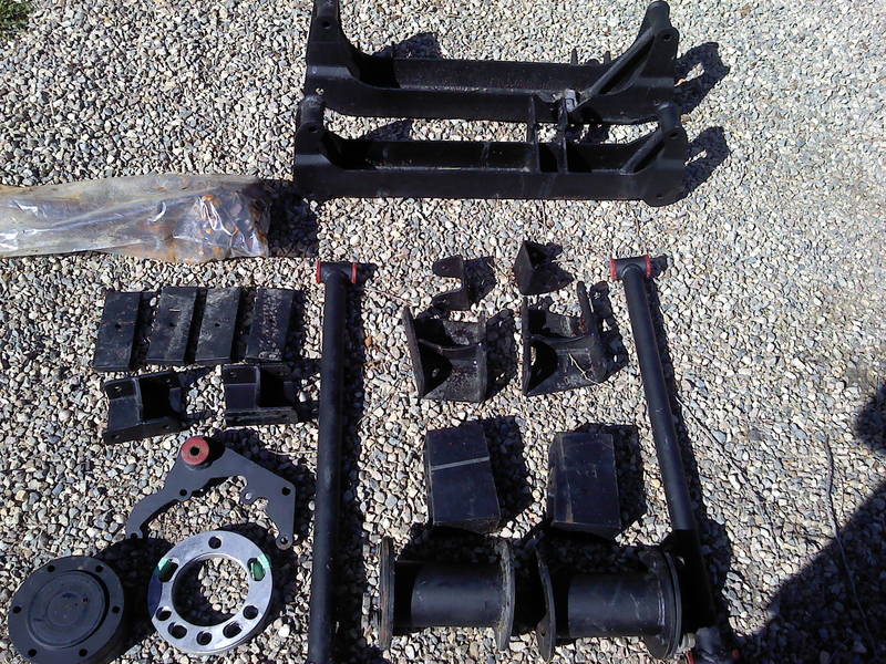

A guy is trying to sell me this lift kit. He says it has never been used but taken out of the boxes and doesn't have the boxes anymore. He says it is a Pro Comp 6" kit. To me there seems to be a few pieces missing. Any help is appreciated. thank you in advance.
No rear shocks, no u bolts, no rear add-a-leaf, and most importantly no spindles. I would pass for sure.
BTW, it definately looks used. What's he asking?
Didn't say a price. He did say that he has the shocks but not pictured. I figured there was a lot missing so thank you for the confirmation. If I could get it really cheap, is there any way to get those parts from procomp? I went to their website but couldn't find anything. I did email them and don't imagine to hear from them till either tomorrow or monday so any help before then would be awesome. Thank you!
Im sure that you could, but I would call them and verify. I would be cautious though with buying that kit though. It may have come off of a wrecked truck which is why he is saying it's never been used.
That kit is the same one I have and is ProComp part# 1143B and you're missing at least half of the parts and the spacers, the large round tubes, are the old style also the black disk on the left is the CV spacer and you need 2 of those.
I'd stay away from it, you'll have alot of trouble to get all the parts you are missing and when you have the truck ripped apart you don't want to find out something isn't ther
Here is a picture of a complete kit, you can see how much is missing.
Thanks guys I figured so from when I first saw it. I will make sure to stay away. I really appreciate the help, thanks a lot.
