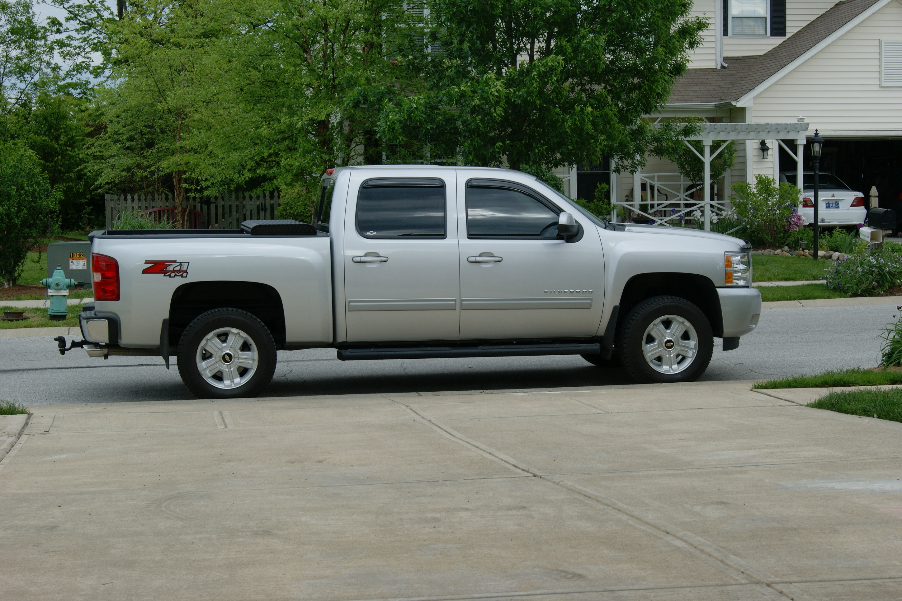

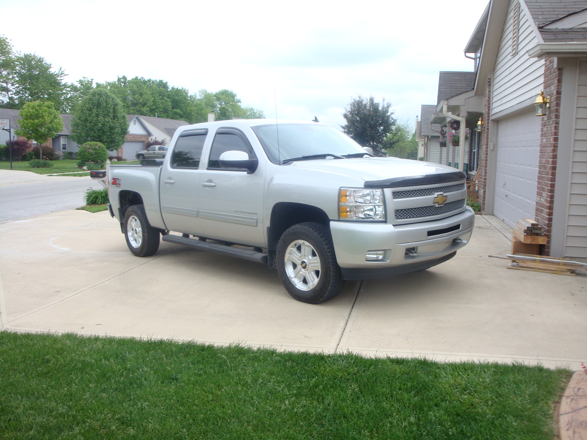

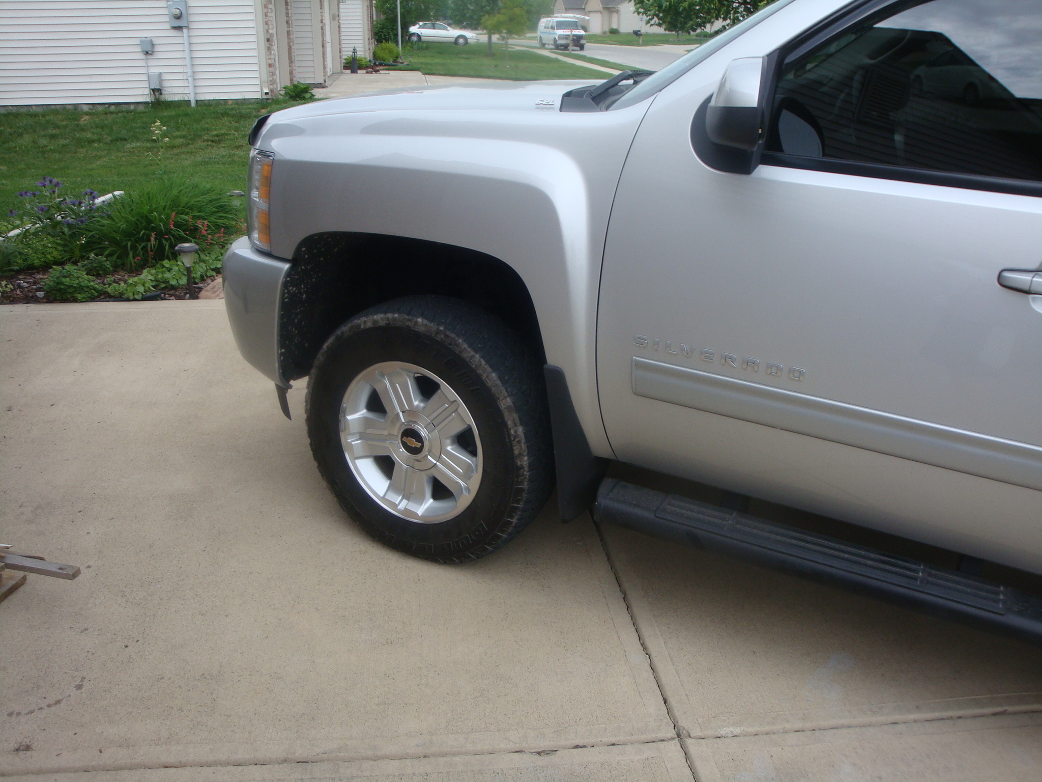

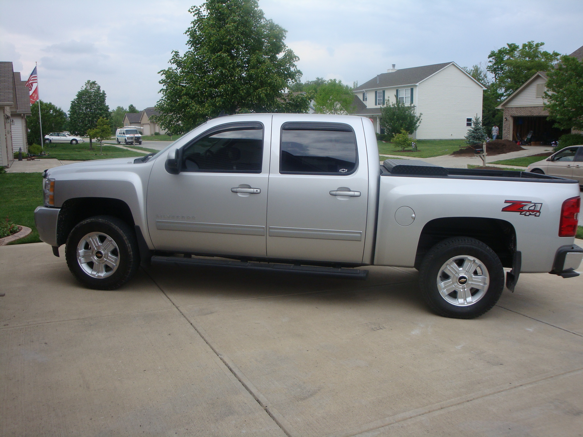

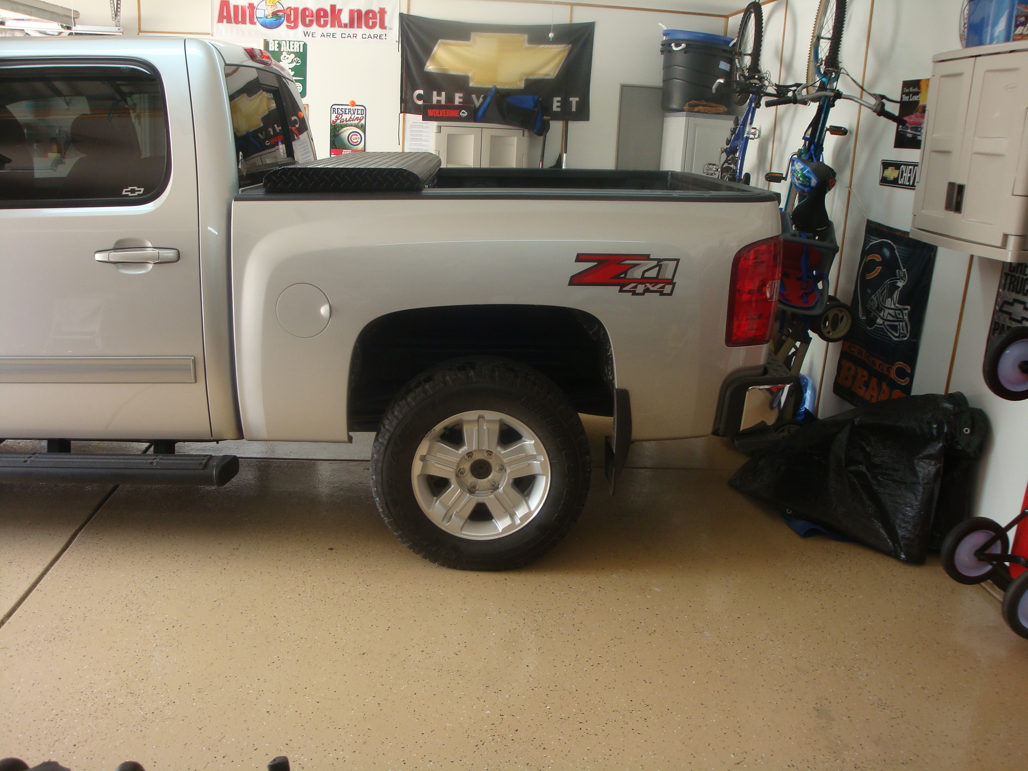

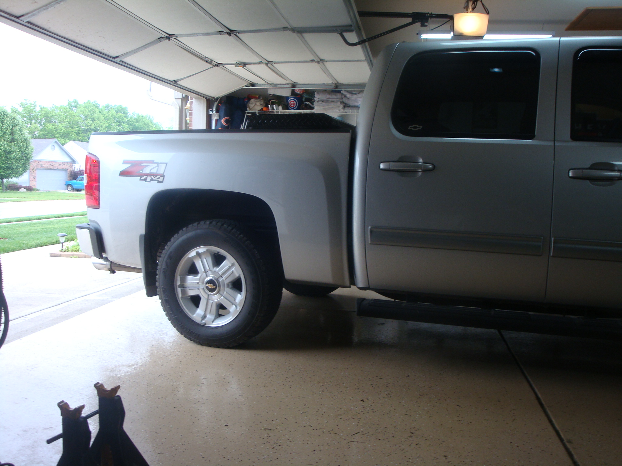

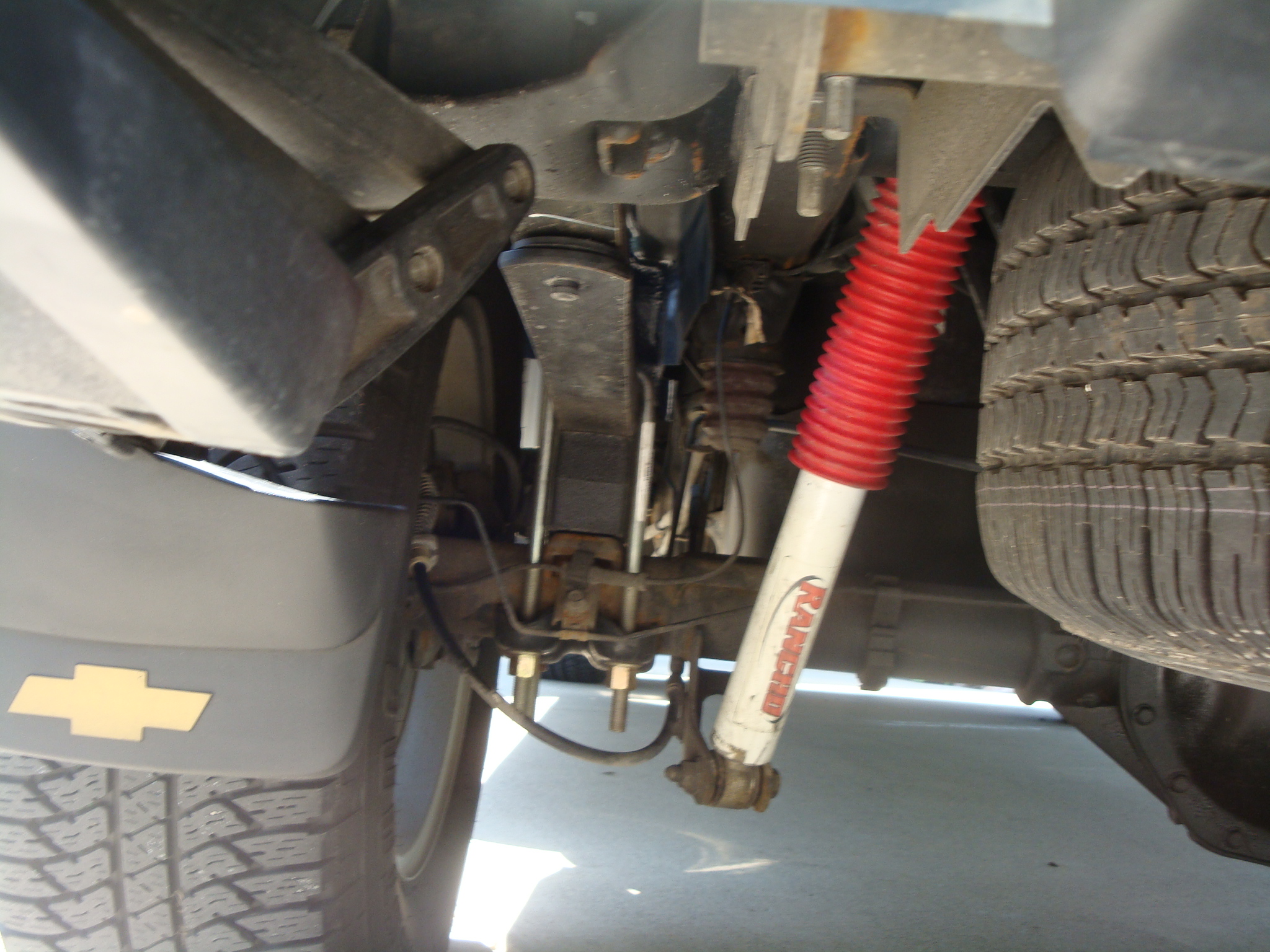

Here are a few photos. Finally had some time and installed both. Now I need some free time to take it in for an alignment.
I definitely can tell a difference on the overall stance, esecially when standing up by the hood of the truck. My wife on the other hand couldnt or she was just telling me that to drive me crazy. Just wait until she tries to get in, you can definitely tell then and she will be cussing me haha.
The last pic is prior to installing the rear blocks. the second to last pic is after the rear blocks (before the front kit), the other 3 (1st 3) are with both products on.

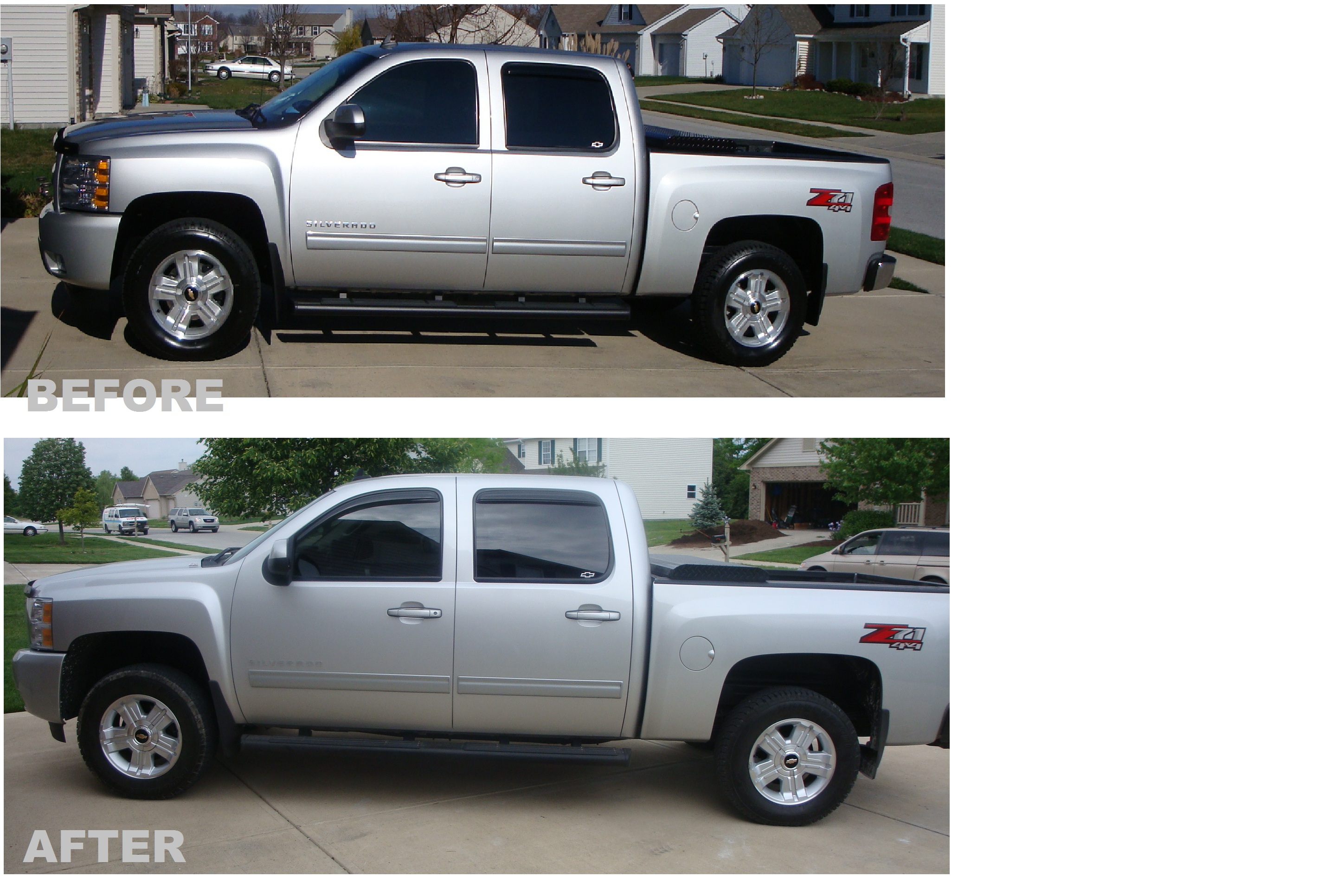

Here is the best comparison before and after photo I could find for now
Measurements
BEFORE
Front Drivers Side: 36-5/8"
Rear Drivers Side: 38"
Front Pass Side: 36-7/8"
Rear Pass Side: 38-3/8"
Ground to top of front bumper: 26-1/4"
AFTER
Front Drivers Side: 38-15/16""
Rear Drivers Side: 39-7/8"
Front Pass Side: 39"
Rear Pass Side: 40"
Ground to top of front bumper: 29"
