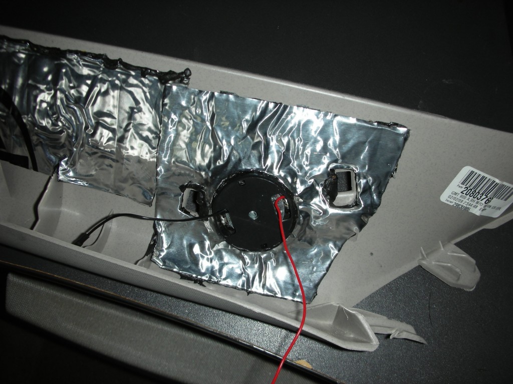

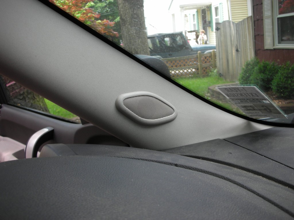

The doors came out fairly well. Still working on getting the bad head unit swap :lol: .
Anyway, for the doors I attached some pics. I got the Scosche bracket adapters for the woofers in the doors:
http://www.amazon.com/gp/product/B0015A8Q7S
Worked well. I ended up using screws long enough to hold the speakers on but also reach the steal of the door so it was a solid mount (that took some precision when it came to lining things up).
The tweeters were a decent amount of work. Not hard, just time consuming. Had to carve out the stock covers and epoxied the mounts for the new tweets to the pillar. Then put a piece of dynamat behind it to double as sound deadening and double stick tap. That thing aint going anywhere. These are the top of the line JL Audio 6.5's, ZR-650 CSI's which may not be in everyone's budget. But with any line the principal would be about the same.
