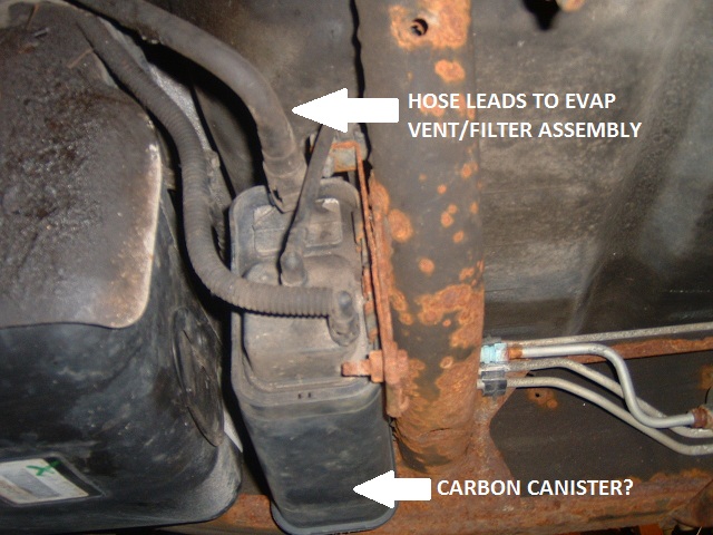

The computer is showing P455 Large Evap Leak so I'm going to replace the evap purge solenoid on my 03Silverado. I’ve researched the installation extensively including the location.I know that if varies from model to model depending options. It appears to methat mine is located above the tank beside the fill pipe just inboard of the driver-sideframe rail. It looks like I may have to drop the tank or pull the box (I’lldrop the tank) to access it. Can someone look at the attached image and confirm the following:
--1. The box in front of the tank is the carbon canister.
--2. The black hose (about 3 /4” dia) leads to the evapvent/filter assembly
