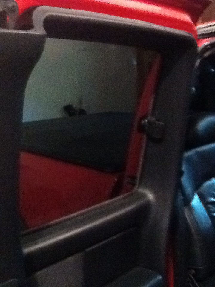

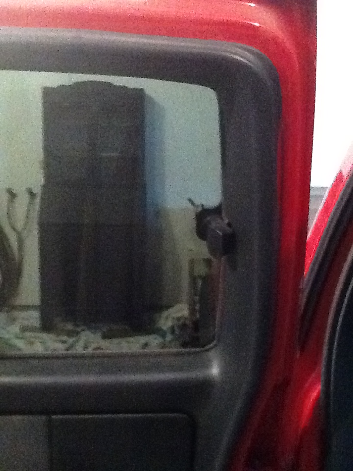

I have had this and found a great solution. I went to Meijer, a chain store like walmart, and bought some weather stripping. It is about and inch wide and quarter inch thick where one side is adhsive. I used this and stuck it to the window around the farthest outside edge. It is covered enough that when the window is closed you cannot see weather stripping very much but if you do it right it blends in with tinted rear windows black edge. I had the same problem with the latch being a little funney and not pulling tight enough. this "fixed" that and I have zero wind noise now. It only cost around 10 bucks for a 10 foot roll. I have had mine on for three years now through the winter and rain and no leaks and none of it has even thought about moving. It is a great a great low cost and effective solution that doesnt look to bad either. I will try and take a few pictures if you would like tomm. This is the autozone equivilent I belive.

Here are the pictures. You will be able to see how deep of a groove the window now leaves in the weather stripping. That is why the latch works again. The added pressure of the weather stripping keeps the latch working very well. You will also see in the bottom right corner where I did not a small section. You could easily fill in this spot but non of that is visible from inside the truck or outside. Inside the truck all you can see is a small boarder that blends in nicley with the tint and unless your looking for it, or have done this, you would not think it was not suppose to be there. Especially if you like me and no one realy rides in the back.
