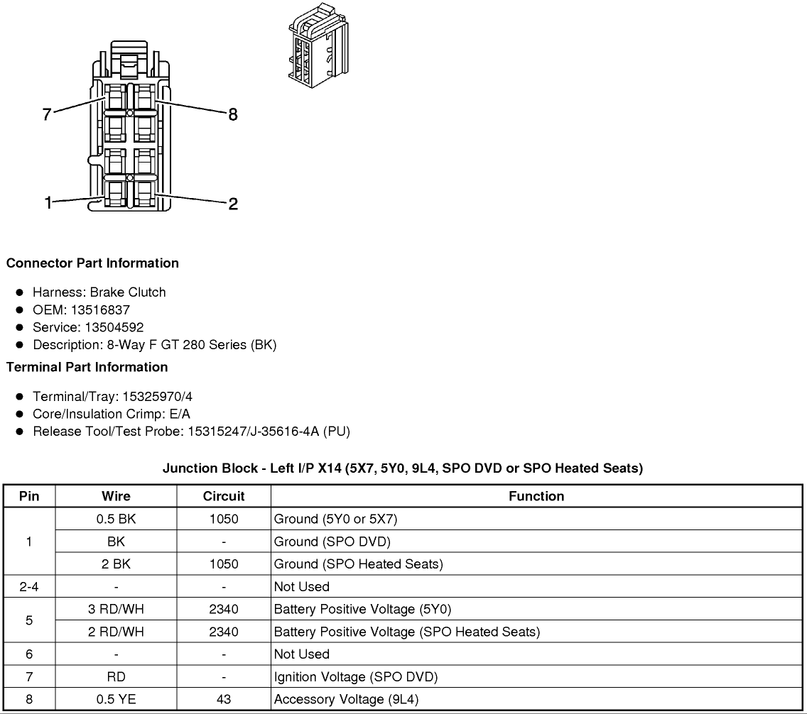

This method should work with the new firmware version: I've been told that the reverse trigger input (Green/White REVERSE + lead in Advent harness) will still be live and will turn on the camera input whenever it sees 12v. I've not yet tested this, but we should be able to get the camera on while driving feature now by simply toggling 12v to that reverse signal lead on the deck. So, standard operation will be that the camera will trigger as normal in reverse (triggered via the LAN), but when you want to see your camera while driving, wire the camera to ACC 12v, then toggle ACC 12v to the reverse input (for almost all NBS trucks, you can get this from pin 8 at X14 on left I/P Junction Block) and you should have camera view. If anyone tries this, please post your experience to see if it works as outlined.
Hey Walt,
I got mine yesterday, and I'm a little confused about powering/triggering the camera based on what you said above. You say pin 8 at X14 is the reverse trigger, but on the diagram it says pin 8 on X10. I just want to make sure I'm on the right pin. Also, just to clarify, I just need to run a wire from that pin through a switch to the green/white wire on the deck to trigger the camera whenever I want, right?

Scott,
The method I outlined above to trigger the camera while driving WILL NOT WORK with the new firmware (10/28/11). They have put that feature on hold and since this firmware revision removed the ability to trigger the camera input simply by supplying a video signal on that wire, we really have no way of activating it while driving now.
The reverse wire I called out was where we used to have to get the reverse trigger for the deck to turn on the camera input. Now you don't have to make any connections to trigger the camera - it gets the trigger via data through the LAN, so all you have to do is plug it in and tell the deck you have a camera ("Menu" - "Settings" - Rear Camera "on").
As far as hooking the camera to accessory power, use this diagram and use PIN 8 on port X14 for camera accessory power (red wire on camera), and use PIN 1 for camera ground (black wire) - you DO NOT need to use the reverse wire - I just added it for reference.
PLEASE NOTE: THE DIAGRAM REFERENCED IN THE (November 1, 2011 7:42 AM) POST ABOVE WAS IN ERROR & WAS REMOVED FROM OUR SERVER - THIS IS THE CORRECT DIAGRAM FOR ALL POWER AND GROUND CONNECTIONS AT X14 & X10:
Here's the factory diagram:
