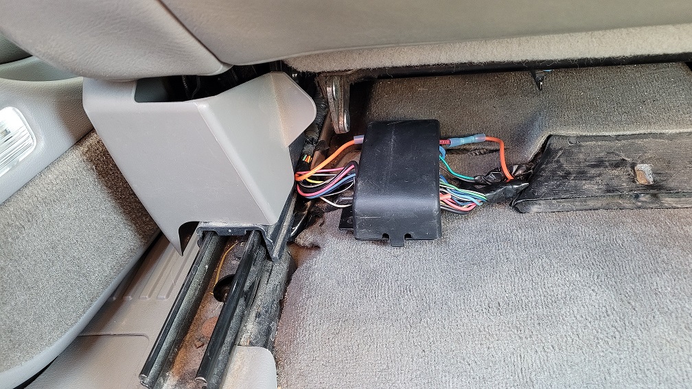

Just something you guys can check that I've run into a couple of times. If the fuse is good and the contacts in the fuse panel/block are clean (corrosion is an issue at times in the under hood fuse block, especially in areas where road salt is used in the winter). Check the main wire harness connector under the seat. Check for power AND ground connections on both sides of the connector (sorry, I don't have pictures). I have found problems with the main ground losing connection due to corrosion. If it's corroded, that damn connector is a royal pain to get apart. If it was loose and caused arcing, the connector body may also be melted. But it's usually that main power connecter under the seat that causes the issues if only one seat is not functioning.
Two weeks ago I had the same problem, drivers seat dead for motion and heat.  Found the connector underneath loose and backed out about halfway and also slightly corroded pins/sockets.  Scraped and blew out the crud and reseated the connector and all works good.....for now.  Note that I use the heater every time I get into the truck, and recline/upright the seat every day when I eat my lunch/nap in the truck.

Hey guys, was having a similar issue. Drivers side specifically heater and now power seat. went to black connector beneath drivers seat in the back side. Disconnected then reconnected and works great now. Was able to at least pinpoint the specific trouble area. Heres a link i found on youtube exact location and connector.

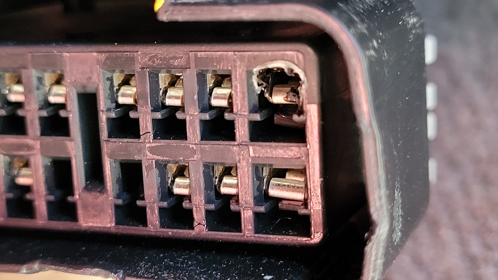

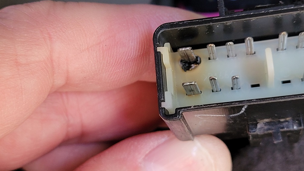

The driver's seat was dead in my 2005 Avalanche similar to what I'm hearing from others here.  The cause was a connector pin that had been damaged from too much current.  I think it's probably the heating element in the seat which I use frequently in the winter.  The driver's seat goes out first because that one gets used much more than the passenger seat in my case.
For those that have a maintenance manual it was the power supply pin in connector C305.  This connector is located under the driver's seat toward the rear.  Mine was mounted to the floor.  You can see that the pin got hot enough that it melted the plastic on both sides of the connector.
Replacing that connector looked very involved.  I did reseat the connector and the driver's seat came alive again but I didn't trust it.  It's likely it would have eventually failed again so I opted to just cut the power wire on each side of the connector and crimp in a new section of 14 gauge stranded wire.
