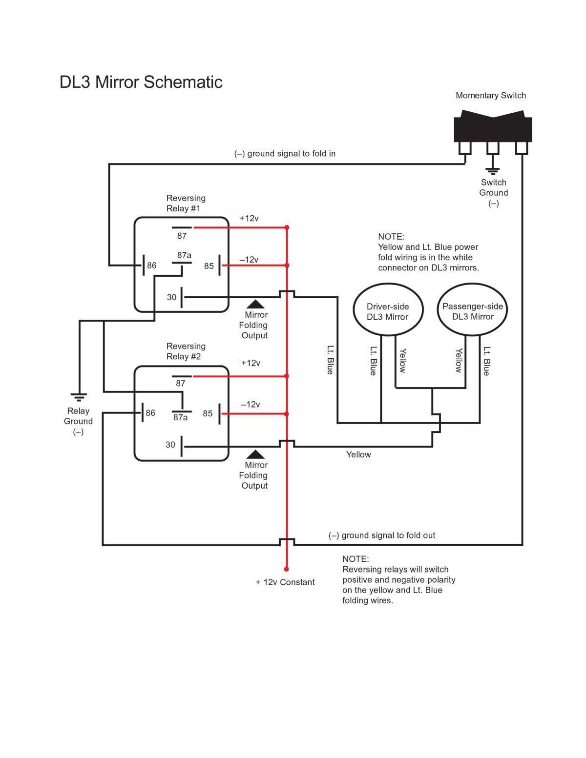

I have 2008 DL3 mirrors on my 2011 Sierra SLE; they work fine. I had to run wires/relays and add a switch to do the folding part, though.

Rt66er,
Can you post a pic and provide more details on the switch you used and where you added the switch for fold? I have read through several threads on this topic but have not seen pics with the install of the switch.
Rt66er,
X2. I have read it isn't possible because we don't have the factory wiring for them....I also read something about adding the passenger side window switch in order to make the power fold work...
I got this schematic (cleaned up version attached) off the "other" GM truck site. You'll need a bunch of wire, two relays and a switch. I purchased the two relays and the switch at a local car stereo/alarm place. I would suggest going to such a store and showing them them the schematic; they should know what you need from that. I already had a bunch of wire left over from a never used fog light install kit I had laying around. I used this schematic originally to successfully install a set of used DL3 mirrors into a 2007 Silverado LT. When I replaced the 07 with a new 11 Sierra SLE, I swapped them over and they worked fine. I mounted the switch on the left side of the dash in the panel below the light switch and mounted the relays below the steering column (the mounting bolts for the steering column worked great for this). Then ran a power wire to the fuse block on the left end of the dash. FWIW, I used a constant power source so the mirrors will fold/unfold whether the key is on or not.
