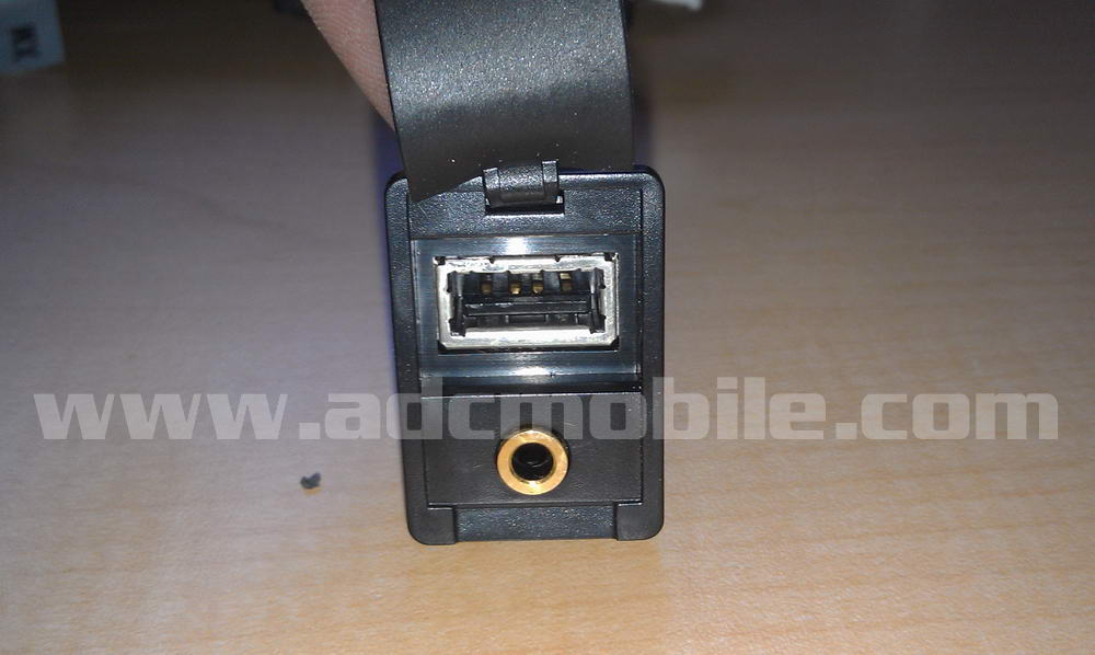

This cable will soon be available for purchase separately, so if you're bummed about the current MediaLink pod, this might be an option for you - I heard it will be about $50...
Any idea when this cable will be available? What does it actually look like? Is it the aux/usb in your pic?
Got a part number on it and ordered 6 of them yesterday - they will run $55 plus shipping. It's a full replacement that's 50" long instead of 38" and will pretty much plug into the same hole as the factory USB jack (you have to shave about 1/64" off the "ribs" on the outside of the new piece to get it to fit in the factory GM hole).

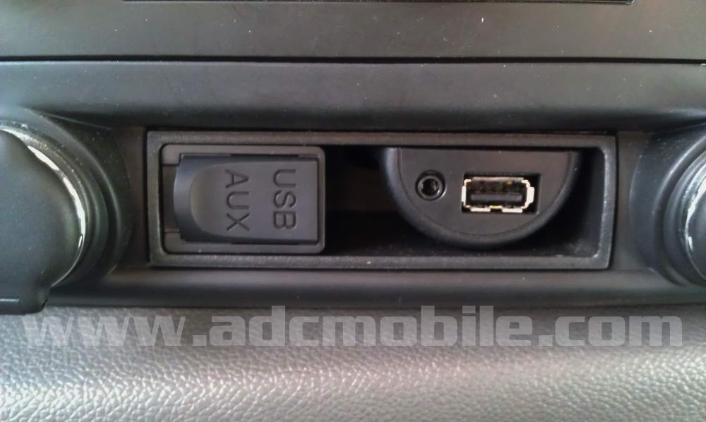

Here's what it looks like in the center pocket on an LT style dash compared to the existing MediaLink pod (it almost looks like it was made for this application!):

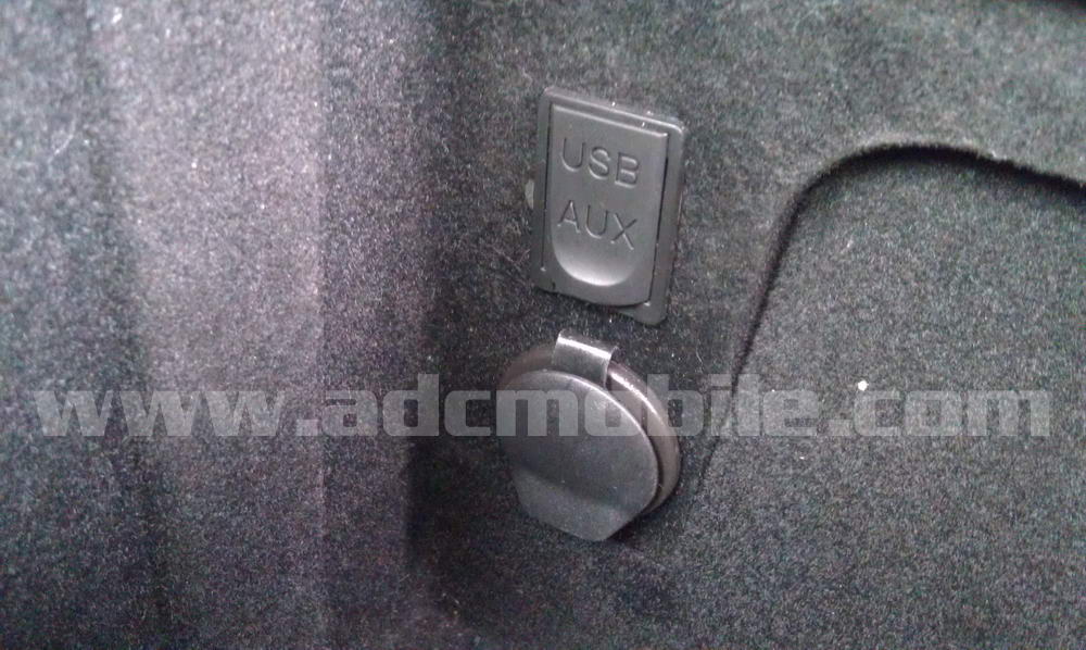

Installed in the center glovebox factory spot (I lengthened my USB cable to give me more room to manipulate my relays and stuff for my WDTV install, but you "should" be able to do this install with the additional length on the cable - it may be tight...):
