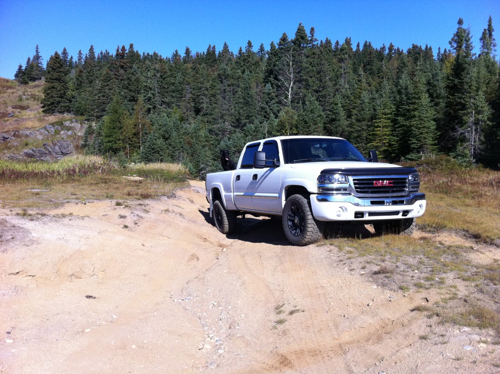

I ran 33x12.5" tires with factory keys...they rubbed. I also ran 285's too, they rubbed on a max turn in reverse on a slant, like backing out of a sloped driveway...that was it. That was no trimming at all either. 285's fit man. Don't worry.
And yes mine was a 2002 285/75 R16
Thanks for the info bud, I really appreciate it. I just wanted a specific answer especially from someone like you who I know takes their truck offroad quite often. Mine is usually a road queen until harvest season and in the winter here. I'm off camber parking in ditches and bouncing through grain rows during harvest season and then in winter we like to go out and see what trouble we can get into. I just don't want to be folding in fenders, ripping out wheel wells, or tearing off the front valance out there. Sounds like I'll have no worries. :cheers:
No problem dude, you know that's just my experience...every truck sits different. Mine was a 2002 RCSB step side, I ran 305/70 R16's (pro-comps), two sets of cooper discoverer STT 265/75's, a set of BFG 33x12.5's(rubbed pretty heavily) and I sold it with a set of cooper discoverer STT 285/75's, I don't remember them rubbing very much at all I think I only had keys turned up a little
Bit.
This is with 285's dirty and my bug deflector is broke lol.
Here's with 265's
I miss that truck...v8 with a Bunch of engine work, 5 speed manual, Sachs clutch, 4:10 gears, Detroit locker..she was a sleeper. I had a little one needed to upgrade in size lol...I miss that truck tho. She was a real gem.
That was one BAD sounding truck! I have always had a soft spot for the step sides too, owned one for a short time and my budy has one with a body lift. My stock keys are cranked pretty hard and the angles aren't anywhere close to bad. If I get 285's and do rub I suppose I can get some reindexed keys and get another half inch out of it.
You have been a great help. Thanks again!
