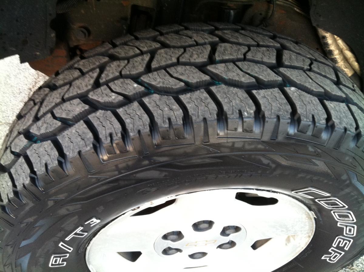

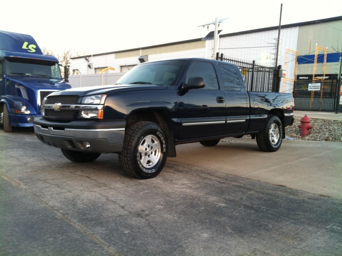

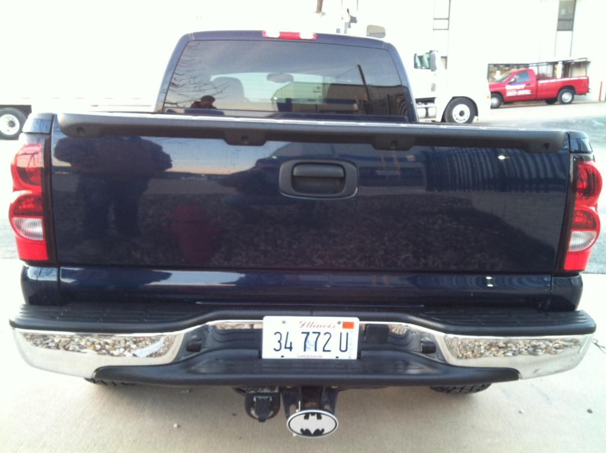

Well it took me a little while to get back on here with an update, but I've made some changes that I'm pretty happy with. First I did the Rough Country 2" leveling kit. I decided to go with Cooper Discovery AT3 285/70/17. I love how good it makes the truck look! While I was at it I de-badged the tailgate and removed the pinstripes. I also installed new Rockford Fosgate speakers. I've been busy!!
Looks sharp!
