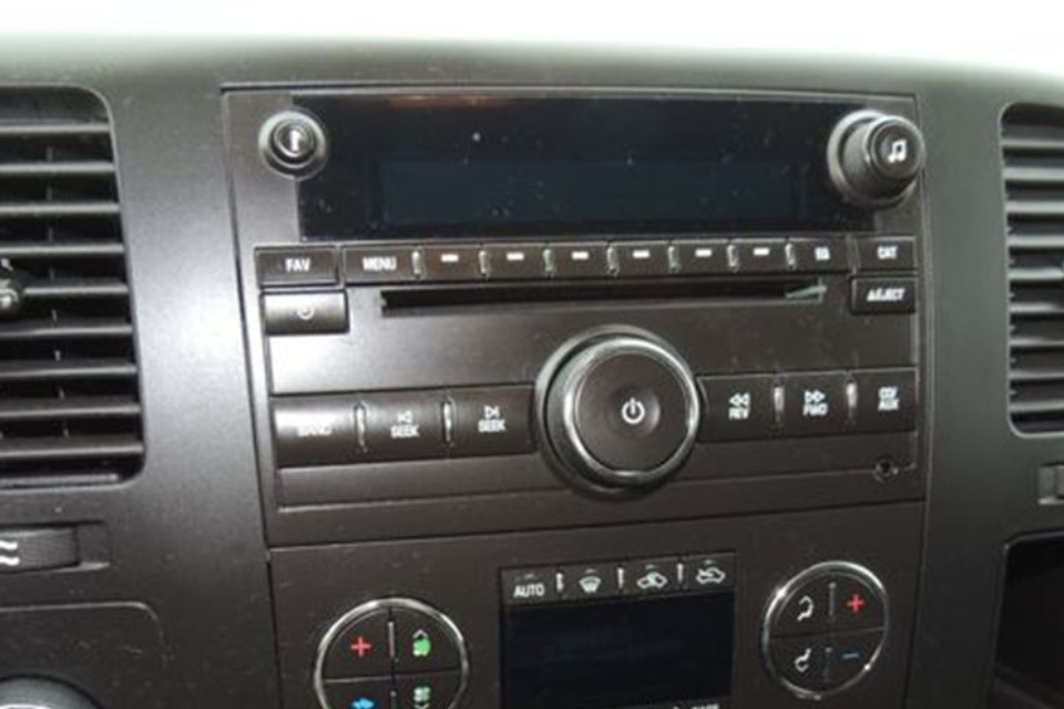

UUI Radio w/USB??
zibzer
Should be one just under the temp controls. Under the flip cover and the other side is a power outlet. And one in the center console. .
My truck lists UUI radio. I only have the USB outlet in the center console. It is white plastic and really blends in with the rest of trim on the truck,lol. It is usually hidden by work gloves and tool belt though.
