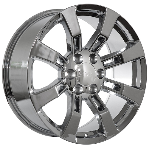

The latter looks like the ck375 22"
Sent from my DROID RAZR MAXX using Xparent Red Tapatalk 2
OE Wheel LLC has a set of CK375 repro in 20". I was thinking of getting a set myself before but decided an 18" with an A/T tire would give me the more aggressive look I would prefer

which offset would I be looking for in my new 20" rims? My current ones are the ones pictured, not sure the offset, maybe someone can tell by looking. Maybe these rims have different offsets with the same look, IDK
Your stock 17's are a 17x7.5 with +31mm offset. All stock 1500 rims have a +31mm offset, but the 17's are 7.5" wide, the 18's are 8" wide, and the 20's are 8.5" wide....so the backspacing will vary accordingly. The more positive the offset, the more the rim is going to be tucked under the fender...which will reduce the chance of your tires rubbing if you go to a larger size.
