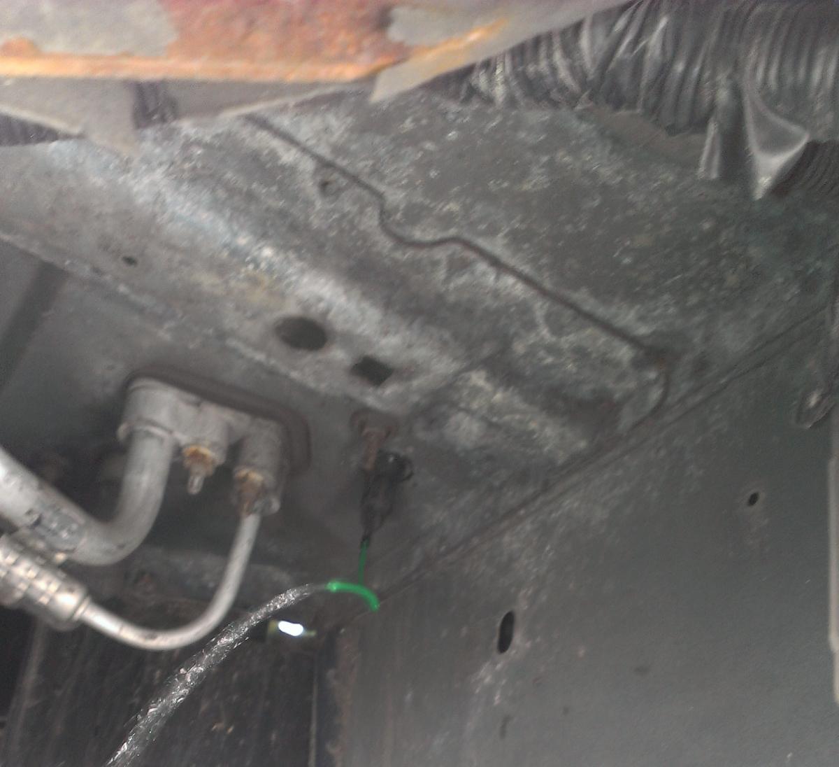

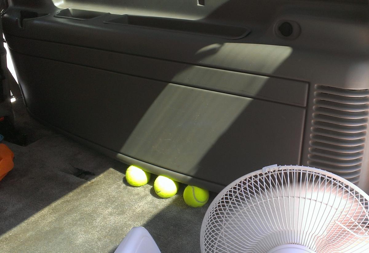

Why is my carpet soaked here?
The carpet is pretty wet behind this plastic trim piece and for an inch or so outside of the plastic. Is there a drain under there that could be blocked or what's going on here? Thanks!
If the vehicle picture has rear AC then there is a evaporator and it will have a drain to be checked
Thanks! Problem solved! I crawled under the back end of the truck, and fed a long piece of weed eater cord back up through the drain tube. I was immediately bathed in the gunk that popped out of the line along with a lot of water pissing out of the tube. lol.
