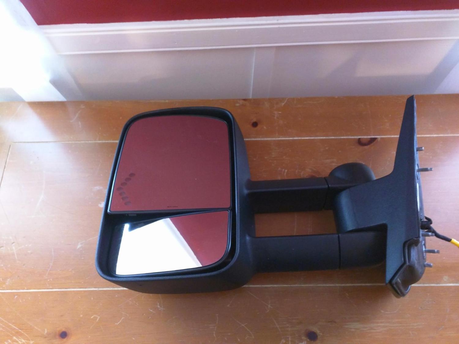

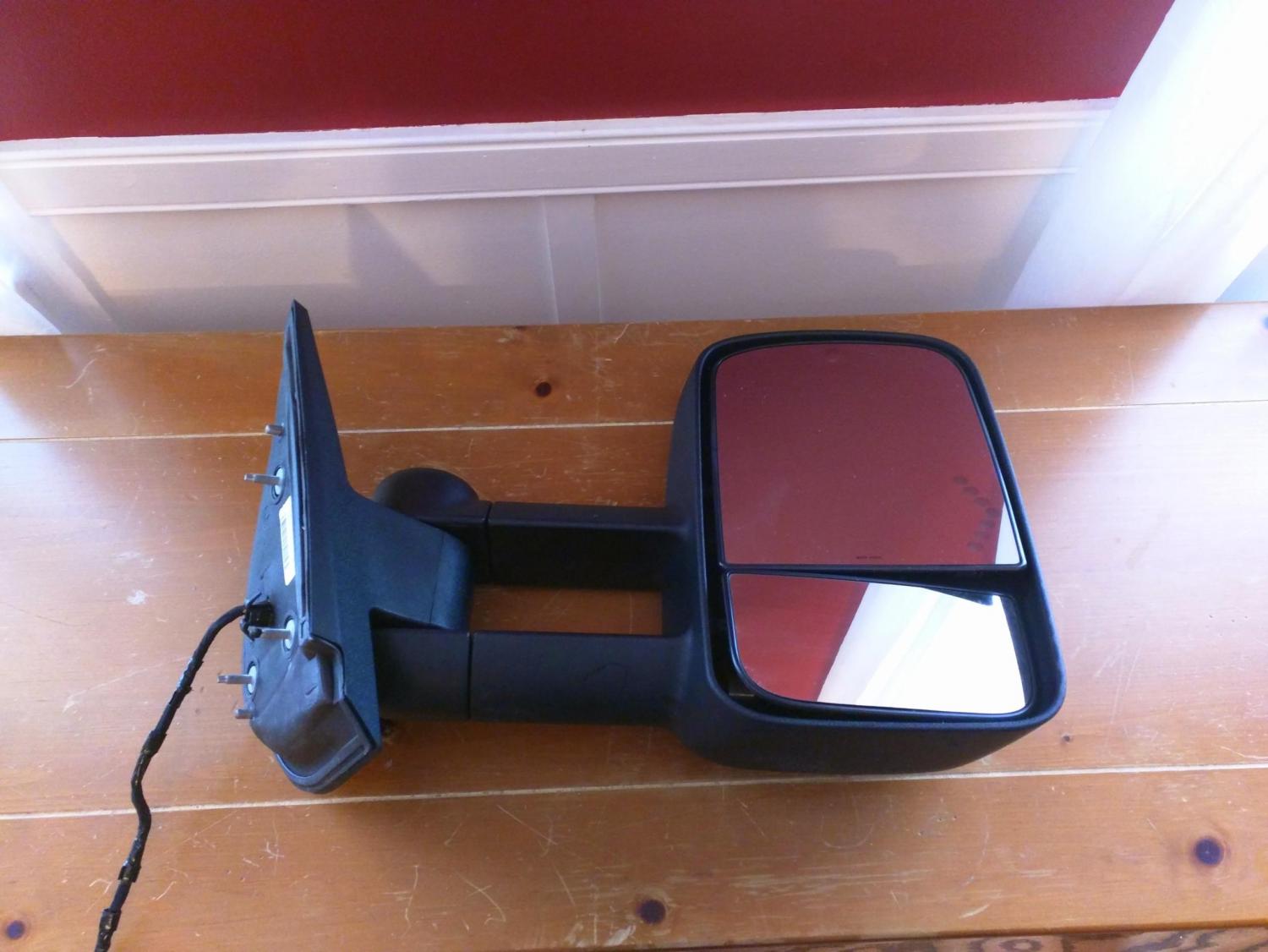

all credit goes to @155Hey guy well I went and bought these mirrors off ebay ..so ill guini pig them..at first glace you would have a hard time telling they arent gm..really nice and seem well built , Im not sure you could tell the difference..anyway heres some install pix and comments. I also decided it wasnt worth the hassle to make signals work so they have power and heat which both work flawlessly.
