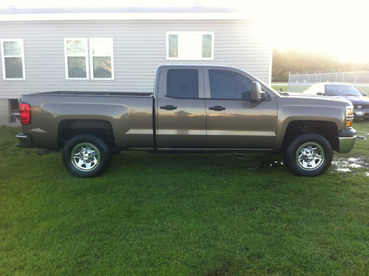

I was told these are GM mirrors, it has GM right on the mirrors when I took them out of the box. Lined them right up next to ones from the factory and they were identical.

Maybe they are full of it, who knows haha. I talked to the guy from that site on the phone and he said they are GM mirrors that they sell. Ill look and see if I can find a GM part number on my mirrors. Everything is good on them, I got up to around 80 this morning just to test and the right one did start to shake/vibrate just a little bit but the left one was still solid. I have tried to find a torque spec on these but no luck yet. Anyone know? If it continues to shake or vibrate I will be going back to my stock ones. And these will be for sale but we will see. THANKS!
