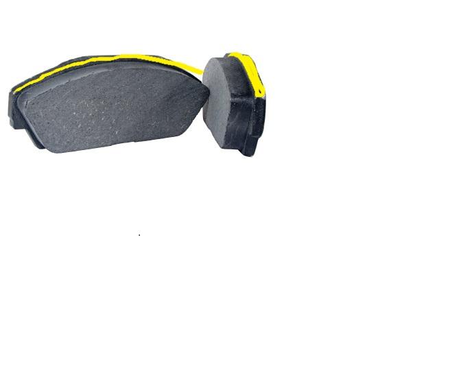

If you are sure that everything is greased and put together correctly, Try flushing the brake fluid and applying anti-sieze to the top edge of of the backing pads. In other words, apply it to the top/inside edge of the brake pad backing material where the caliper covers. So besides applying anti-seize to the brake pad ears, continue down along the top edge of the backing pad and shim. I have fixed a few other cars by doing this because when you step on the brakes, the caliper dives down a little bit and rubs on the top edge of the backing pad, making a squeal noise. Sometimes there is enough play in the caliper mounting bracket or hardware that the caliper moves just enough to rub on the brake pads. The anti-seize will lube this area and provide a barrier to stop the backing pad and caliper from rubbing together, stopping the squeal noise. If this explaination is confusing, I can post pics later.

I think I get what you are saying about the anti-seize. Is it the highlight part in the picture and are you talking about regular copper anti-seize? Would brake grease work too or should i use the anti-seize?

Mossy- Yes that is exactly what I am talking about! Use a q-tip or small acid brush and put on a generous layer of anti-seize to the area of the pads you highlighted, the edges of the pad ears, the piston faces and the caliper fingers on the other side of the pistons! Use anti-seize, not brake grease. High temp brake grease of any type is too "wet" and will catch too much brake dust. Also, the solid lubricants in your anti-seize compound; Copper, Graphite, Nickle, etc... will be the only thing strong enough to make a barrier between the moving parts. Any type of anti-seize is fine, Copper is great! The only place you should use brake grease or sil-glyde is on the caliper pin bolts and boots. Inspect and clean all of your brake hardware and make sure none of it touches the rotor anywhere. Have an assistant step on the brakes while your wheels are off and the truck still up in the air. Look for anything rubbing or moving that shouldn't be. Put the wheels back on and then spin the front wheels by hand and have the assistant step on the brakes again, see if you hear any noise or see anything else possibly wrong.
