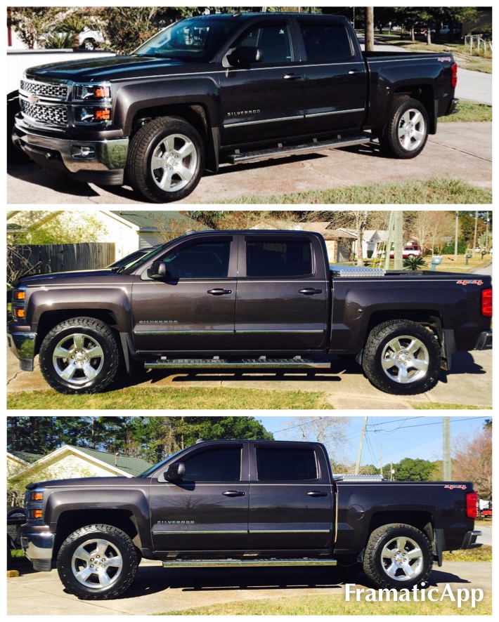

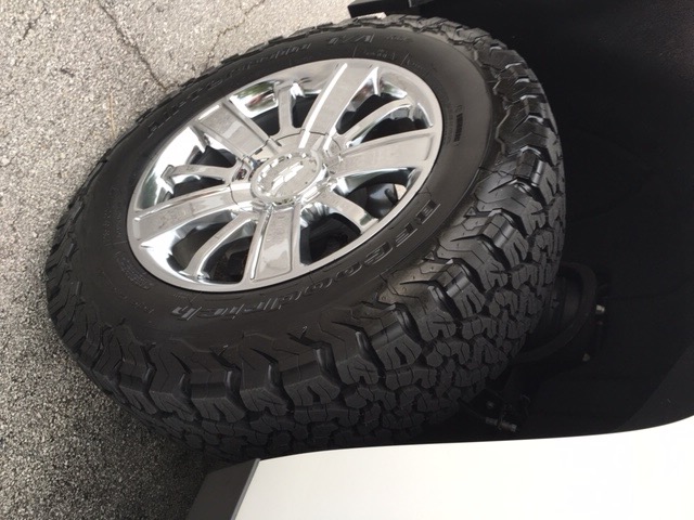

Thanks to this thread, I pulled the trigger on the 285/65/20 BFGs! There is some rub at full lock, though I haven't experienced it while driving. I will zip tie when I do, or move to a wheel with an offset that will push them out a bit. Love the stance and ride with about 50 miles on them!
Before and after:
Can you take a pic down the side when you've a chance thanks in advance
