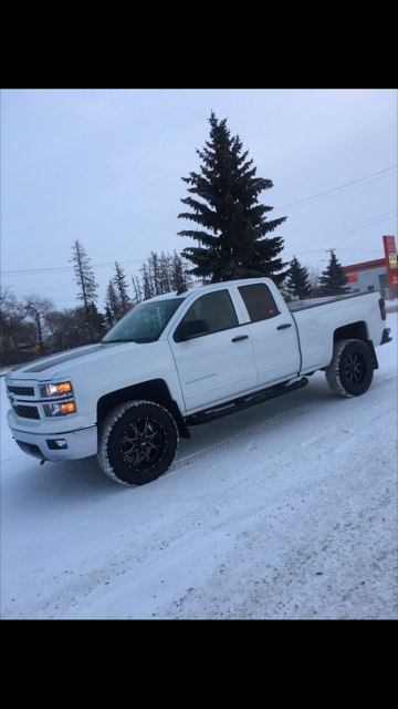

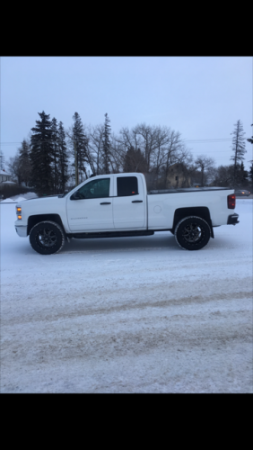

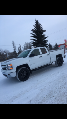

Front/Side View with 34.6" Tires
Front View with 34.6" Tires
Front/Side View With 34.6" Tires

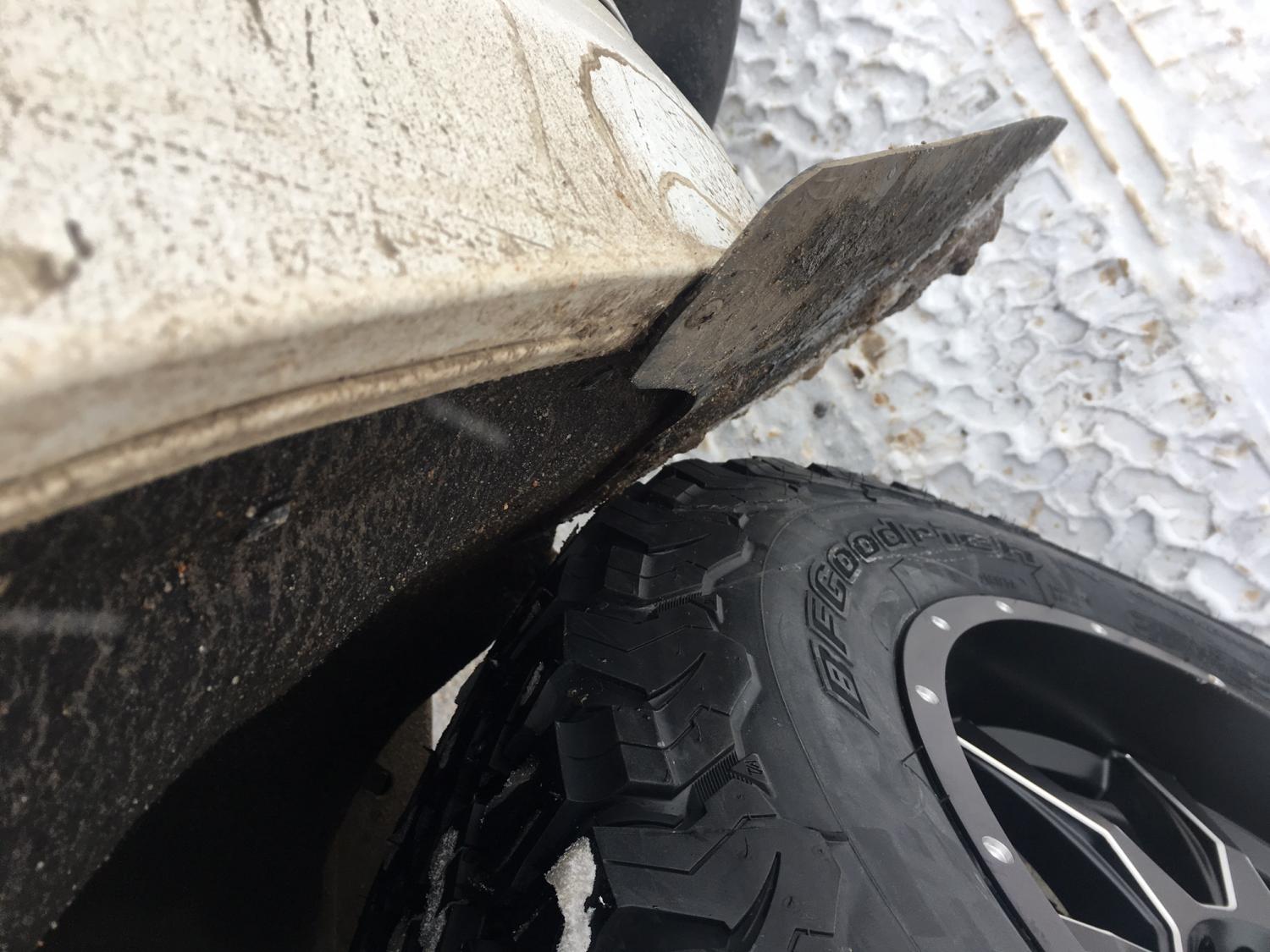

This is litte late but for future readers, 2inch level will not work! Regadless what you read. I have 285/65r20 bfg ko2s and 3.5inch lift front and back and the just pass the mudflap maybe 3 mm if that. You need a 4 inch or more to safe with no trimming. I havnt trimmed yet but if your off road you will have to. Its closest at 3/4 cranked. Then full crank you gain more room again. I wass dieing for a week straight wondering if these would fit so hears your guys answers! Cheers!

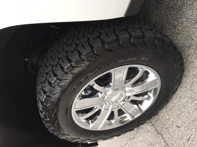

FALSE!
It works fine on my truck with 2" level up front.
Your problem is because you're not running stock wheels. Stock wheels and 285/65r20 wheels work fine with pulling fender back.
See how much room I have!
