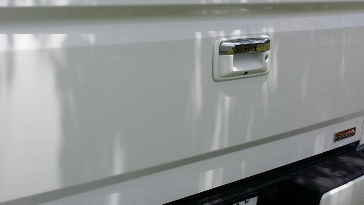

I removed the big GMC and the sierra emblem couple days after I got mine. Since I work at a body shop, all I did was use a small plastic door panel remover tool to pry the emblem off the tailgate. Then used a air eraser to remove the glue and no holes any where just left all terrian in right corner. Looks clean.
Also added the chrome tailgate handle and painted to match.
