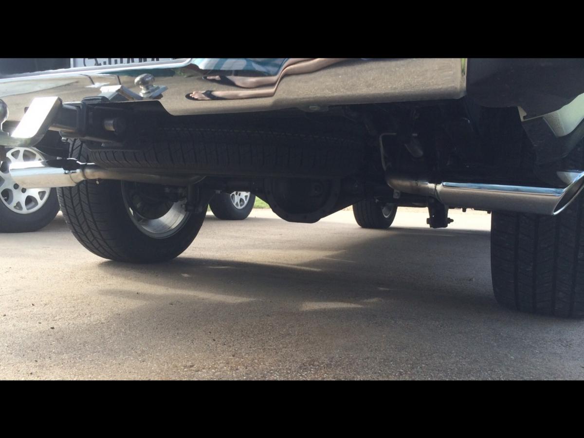

I realize that this topic has been discussed exhaustively on this Forum. What I
gather is that the factory exhaust must be chopped in half to clear the rear axle
for removal. I have read that you have to lift the truck by the frame to attempt
removing the factory exhaust in one piece. I have a Magnaflow cat-back system
showing up tomorrow and I would like to hear from anyone who knows of a 2014
factory system (6.2 specifically if that matters) being removed in one piece. Tips
on doing it would be helpful. Thanks in advance.
It was very simple. Easier than I had anticipated in fact. Just take the clamp off and remove the stock system from the hangers. I lowered the front after un bolting and took it out forward turning the entire system 1/4 turn to get the rear part over the axle and it was out. The whole swap out took just under an hour and I took my time and cleaned things I saw that had accumulated dirt.

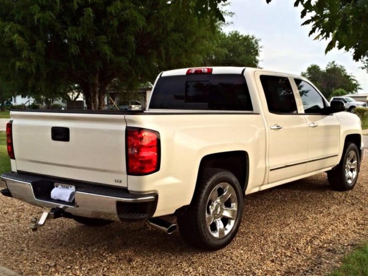

Thanks bud, that is exactly what I was hoping to hear. I'm going with a 4" Magnaflow stainless cat-back with 22" muffler
and resonator with single 5" tip exiting in the factory location. I'm hoping for a 'pre-catalytic converter era' sound.
(what used to be considered normal, years ago, as I remember)
Thanks for the help. I had it laying on the ground in about 30 min. Did you happen to ream out your 3rd cat ? It's kind of tempting.
any benifit of changing exhaust mpg? power ? or is it just for the nicer sound
Just sound
I think I'll resist the urge to broomstick cat #3 - I guess I could go back in there later if I have to.
Looks like you got it figured out. But yea, I got my stock exhaust out in one piece as well.
Enjoy the Magnaflow!
Man...that's to easy....knock that sucker out! (insert evil laugh) I think I might have to do mine when once I get it.
Now you've got me thinking, I guess I need to hear from someone who's done it.
