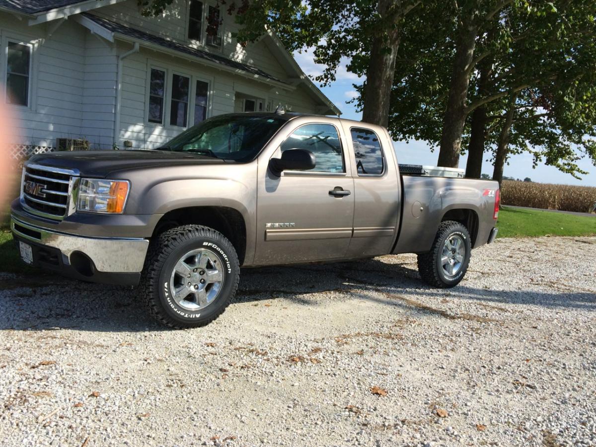

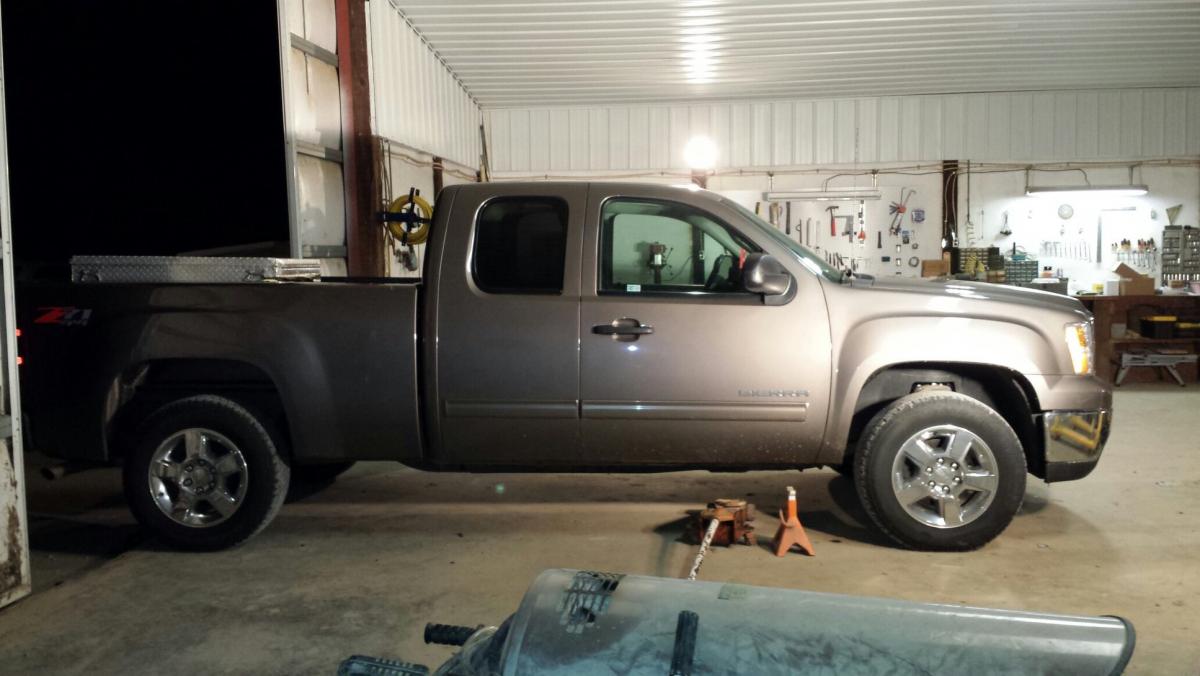

Before and after.
2inch rc leveling kit
275-70-18 bfg tkos
It does make the truck look a lot better
Now for an exhaust and maybe a small body lift.
