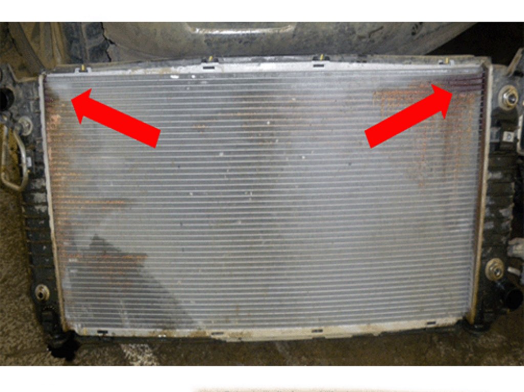

The invoice also states replaced radiator and thermostat per bulletin #pil513. Radiator is leaking along left hand tank.
http://sandyblogs.com/techlink/?p=5128

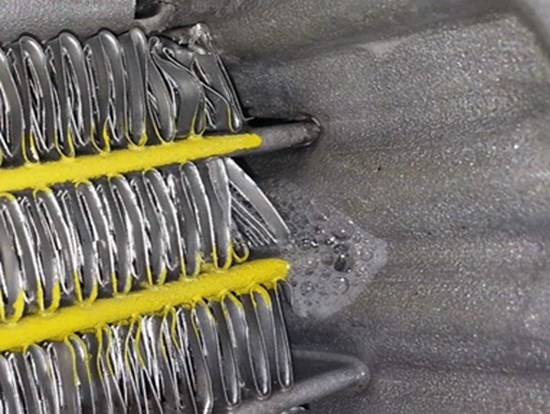

An engine coolant smell may be noticed while driving some 2014-2015 Silverado, Sierra; and 2015 Tahoe, Suburban, Yukon models and Escalade models. A coolant leak also may be found under the front of the vehicle.
Inspect the radiator for signs of leaks, especially where the tubes attach to the headers. (Fig. 3)
If a leak is found, it may be the result of excessive thermocycles within the cooling system caused by excessive cycling of the thermostat. The excessive thermocycles may cause the tubes to fatigue, crack and leak at the radiator headers. A new thermostat has been designed that eliminates the thermostat’s excessive cycling. Replace the radiator and the engine coolant thermostat housing, which includes the thermostat.
I've noticed the smell and steaming from the upper passenger side for about 6 months now. The dealership has been unable to find anything they say. When I got home from the dealership this last time I could smell it. Today I decided to remove some covers and was not surprised to see the top passenger corner showing signs of leakage. Called the dealership back and told them to order the radiator but they will not without seeing the problem.....needless to say its going back with all the covers off so "Ray Charles" can see it.
