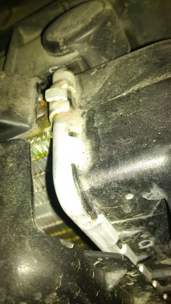

Im not going to lie I'm pretty upset over my experience with this. Ive had the truck in the dealership 3 different times for this issue (sometimes with multiple issues) but each time deemed as "no problem found". So about two weeks ago i called into the service dept and said "look i know you guys haven't been able to track this coolant smell/leak down so i was wondering if you'd be able to put some dye in the system before i leave for the week, that way we can check it when i get back." The response i got was " Dye? i don't think they make that for coolant, I've never heard of that before.", so i gave up on it. This past week i was out of town for work and when driving my truck i noticed a very strong coolant smell coming from the vents. So this weekend i finally said screw it and started to investigate myself. Low and behold after taking the two bolts out of the passenger side cooling fan and pulling back a little i see from the pass top corner about 6-7in down the radiator is covered in crusted coolant and fresh coolant in the fins.This has left quite a bitter taste in my mouth, as i don't want to start any problems at my dealership but I'm really disappointed with this. I called in on monday making sure i didn't loose my cool, I explained everything and said ill send the pictures i took to you. The response I got; "don't bother, ill just order you a radiator." Its now three days later, have yet to get a follow up call to schedule an appt, I'm loosing coolant slowly but surely and i have the thought in the back of my mind of "….so did they know it was a radiator the whole time and just put it off and put it off? because they just ordered one without wanting to look at it again." GM needs to help me out here because I'm really frustrated.
