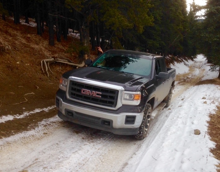

It's been 8000km on the KO2's I'd thought I'll do a quick review and talk about some of the problems I ran into.
First Impression
Definetly a really good looking tire, better than the old KO's in my opinion. Having said that, it could use a little more work to avoid looking like the Grabber AT 2's.
Winter&Around Town Performance
This canadian winter haven't been all that cold so I have quite a few chances to plow through thick slushes and glossy icey roads. The truck usually stay in 2hi for 95% of the time but does require 4hi when trying to get going after a red light. Stoping on snow packed streets feels quite secure and with little drama. Although traction is not as good as dedicated snow tires but sastifactory when compare to stock all seasons.
Off Road Performance
I admit I only took it off road once back in December but what it did was simply mind blowing. Most of the dirt road was cover in a knee deep snow on a sheet of ice and frozen ground. I kept the tires at 40psi to see just how far I can go.To my surprise, 40 psi provided me enough traction for the entire 2 day journy into the Rockies in the dead of a Canadian winter. We tread through steep rocky hills, snow covered river banks and icey hill climbs. The traction was simply unreal in 2hi and I feel unstoppable in 4hi. Way better traction than the MT 33's on my uncles tundra in my opinion.
Highway Performance
The KO2's are quite a bit louder than your "P" rated tires at highway speed, but nothing you can't cover with a louder radio. Having said that it does firm up the ride a lot, partially eliminating some under damping the 4 ply stock tire provides.
Balancing Issues
I've been getting vibrations at highway speed since day one. Had them spin balanced twice with very little results. After some inquires with you party animals on this forum, I took the advice and had them road force balanced. The result just came in and 3 out of the 4 tires on the truck is bad, 3 out of 4! I understand this is a new tire for BFG and some manufacturing error is well justified but 3 out of 4?! This is a bit alarming. Anyways I will send the tire shop the report and have them sort this out. I will update on BFG's customer once this issue taken care of.
Final Thought
I dare to say it's the best tire I've ever had(beside the obvious vibration issue). If you're looking to get great traction on all type of terrain and under all conditions, this is the tire.
