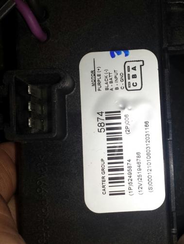

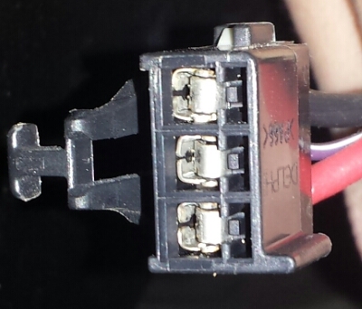

Okay. Well I went online and looked up videos on youtube. So I know how to replace the resistor. Now the question comes that my resistor looks nothing like the ones they are replacing on the same year of trucks. There's looks like a 7 plug where mine is a 3 plug....mine doesn't look burnt or anything. Looks to be in good shape...I will post pics of mine...you all think it's still the resistor that I should change abd should i still worry about the wire? Thanks for all the help...
I think after looking online a little further it is going to be difficult to find this resistor at an auto parts store because if it has three prongs like mine it is for the auto temp control type. Which is what my duel climate control is...So it looks like I am going to have to order it and just trying to find out that this is definitely the problem before I order it and not be the problem...
I just kind of want a little reassurance that everyone thinks that it is the resistor that is the problem before I spend $100 on a part that doesn't fix it and then can't return...

Ok. Went to the parts store and they told me if I bought the resistor that uf it doesn't fix it then I could not return it...so instead of possibly wasting $100 on the part. I went back home and used a jumper wire to run power directly to my blower motor to make sure it was still good. It checked out to be good. So went back and bought the resistor and had to wire it in cause it goes from a 3 plug to using a 5 plug now but it was simple and fixed the problem. Thank goodness cause we are prejected to get up to 8 inches of snow tonight :-) Thanks for all the advice and help...
Happy to read it is fixed. Looking at the replacement you would never expect it to actually connect, even using the patch cord it came with. Yours was a three wire, new one is a 2 wire, with a 5 wire patch cord.
