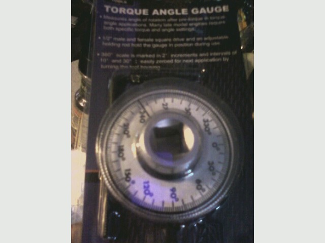

And you need one of these when installing TTY bolts - tells you the angle in degrees. The manual specs will tell you all of that info.
