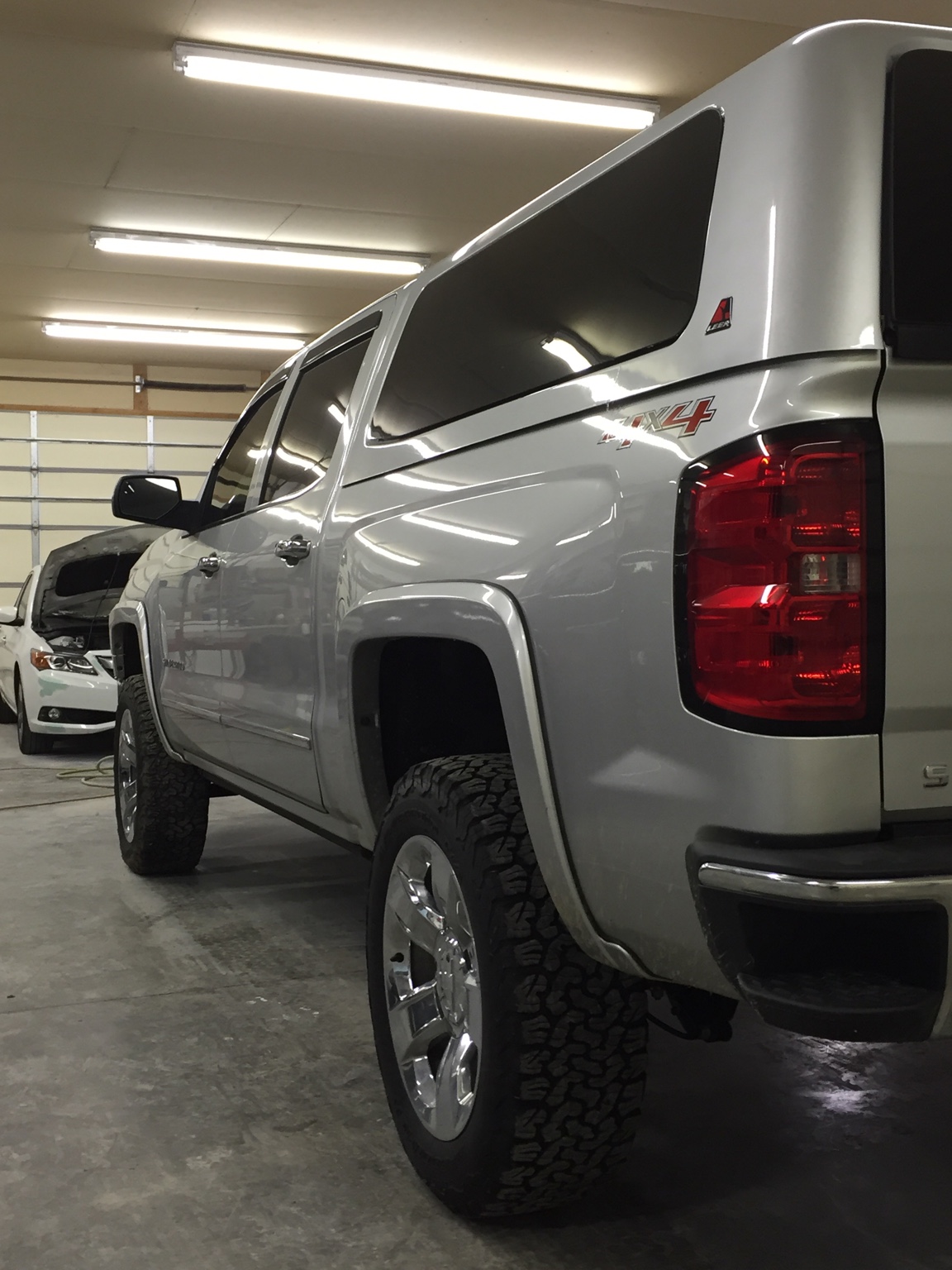

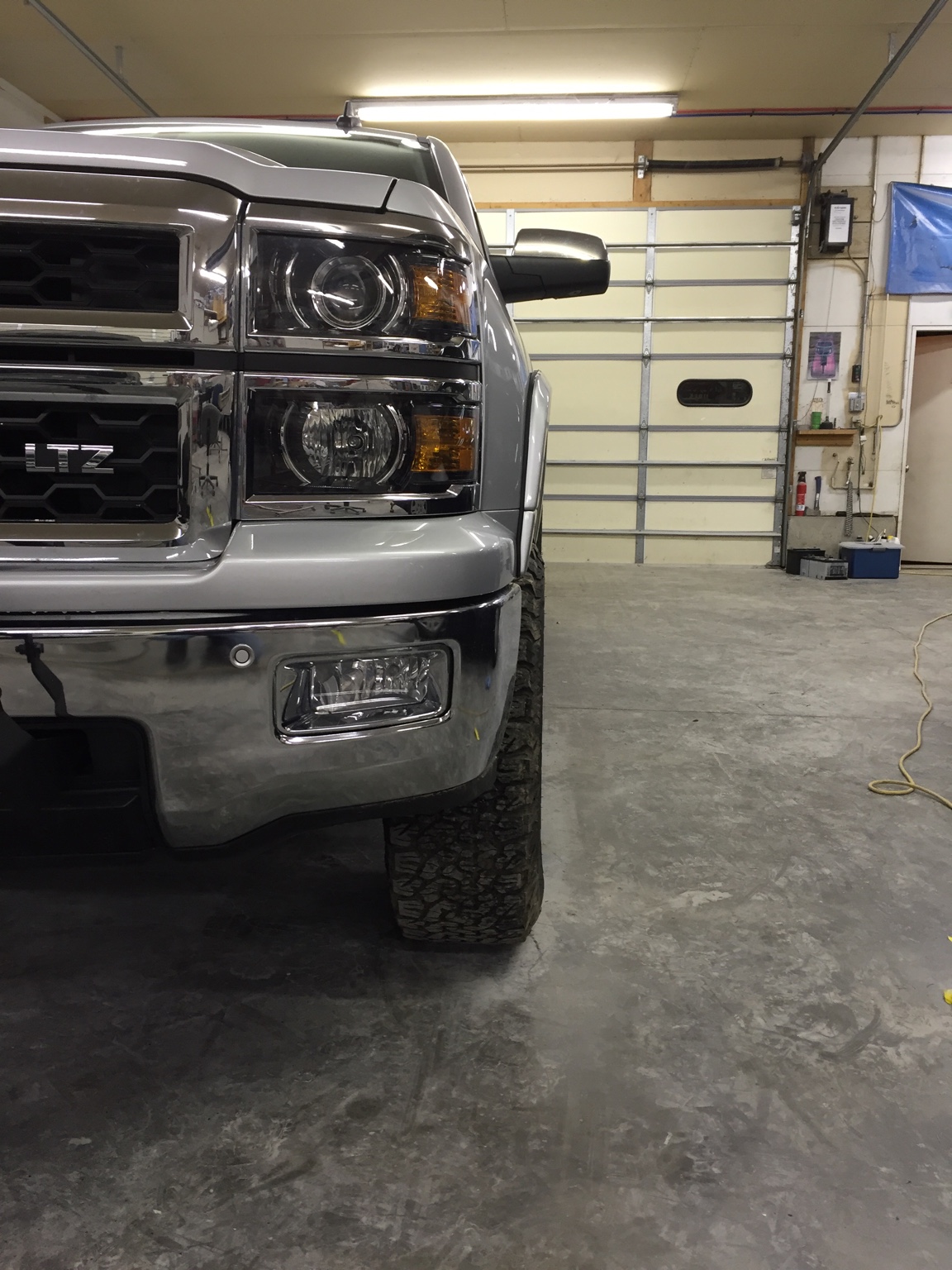

hey do you have any pics of the spacers on your truck? I have a 2 inch level kit, on 285/70/17s and was wondering how much they stick out, and if they would rub
My truck has a 1.5" Zone body lift now along with the leveling kit and add-a-leaf so keep that in mind when looking at the pics. The Bushwacker flares stick out an additional 3/4" also.
Once in a while my LF tire would rub the fender liner when backing up but a zip tie easily fixed that. With the body lift it has plenty of clearance now. My tires are 275/60/20s or approx. 33"X11"
