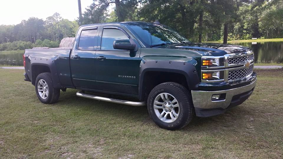

Thoughts on wheel spacers?
Hult

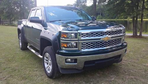

Grrr, I think 1" would be perfect. Don't get me wrong, your truck looks great, but that might be a tad much and do some chipping to the sides. Your back looks great, but the fronts seem to poke out a tad more. Or maybe it's just the angles.
Sent from Tapatalk App - Samsung S6
That's not my truck lol but I agree any negative offset will be prone to rock chips etc. That's just a negative of negative offset ;P. I want to run 2" spacers eventually but right now I have no spacers.

Was gonna say those don't poke out at all, buy I see the fender flares now. :)
I know everybody wants hub centric, but what about wheel centric with aftermarket wheels? Would just hub centric suffice? I am trying to get my rear track width the same as my front end. It seems my front end tires extend about 1.5"-2" farther than my rear end tires.
