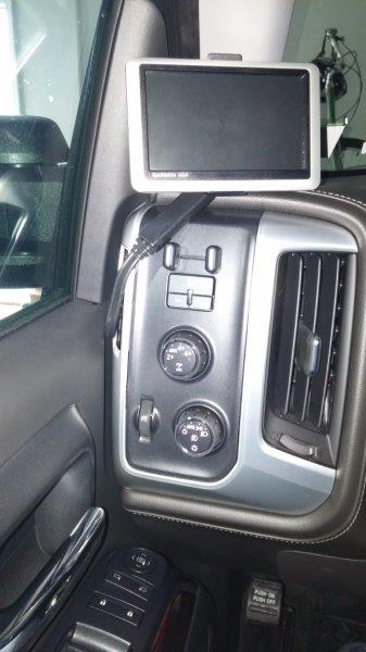

With a few great ideas from this forum, I've finally found a suitable place to mount my Garmin. It's tucked in a corner of the dash, so not readily visible from outside, yet is easy to view and reach from the driver's seat.
Above photo shows where I've mounted the Garmin. It's actually attached to the door, not the dash, to be a bit less visible from outside. But you can mount it on the dash as well (but then it has to be positioned a bit further away from the windshield post).
You should be able to see the pretty thick power cord easily tucked behind the door gasket. At the bottom, you may be able to see a bit of the white part of the wire as it snakes under the dashboard. CAUTION: If mounting the Garmin on the door, leave enough slack in the wire before tucking it behind the door gasket. Otherwise when you open the door all the way, the wire pulls the GPS off the door!
I used the standard Garmin suction mount, but added a Suction Cup Buddy purchased from eBay. It's a non-adhesive disk that seems to be clear silicone. It's very grippy and is sticking to the hard plastic corner of the door panel. It can also stick to the top of the dash.
The other end of the power cord is plugged into a female power receptacle that I wired in to the #10 (ground) and #8 (12V RAP) discussed in http://www.gm-trucks.com/forums/topic/155775-2014-rap-retained-accessory-power/ This way the GPS automatically powers on with ignition, and shuts off with ignition off, after I open the driver's door, or 20 minutes later, whichever comes first.
Hope this helps others out. It was easy to do and works well for me!

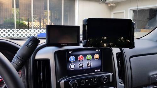

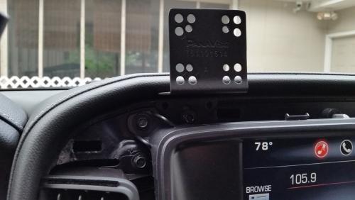

Hmm, neat idea! Here's how mine is mounted using a PanaVise mount (I grew tired of the suction cup always coming off).

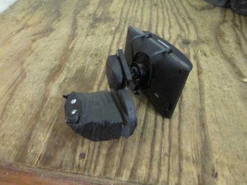

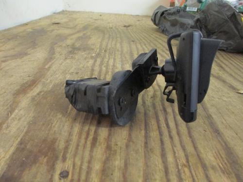

The people "without the built in trailer brake" this setup has be working great for me. No issues of falling out and stays firm with the window down. It is out of the way and close enough to see when driving. Out of the sun. I made it so no screws are exposed to cause scratching etc.. With the tinted windows you don't see it from the outside when it is parked. I put a black hat on it as well to prevent it better to be out of view.
