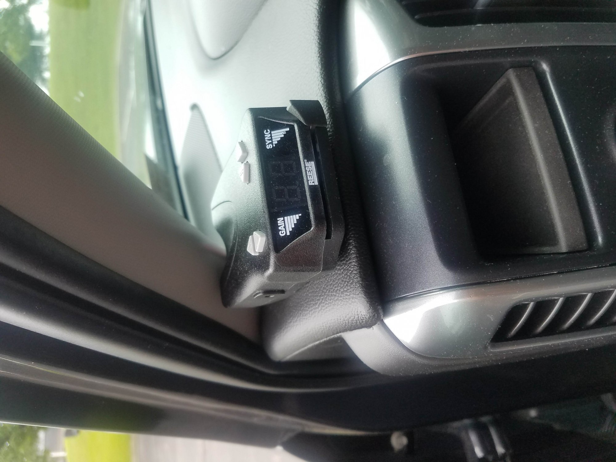

I got a Reese with the Reese harness that plugs directly into the fuse box.  Pulled the side of the dash ran the wires down and 3m double sided taped it to the dash.  Nice and easy reach.
