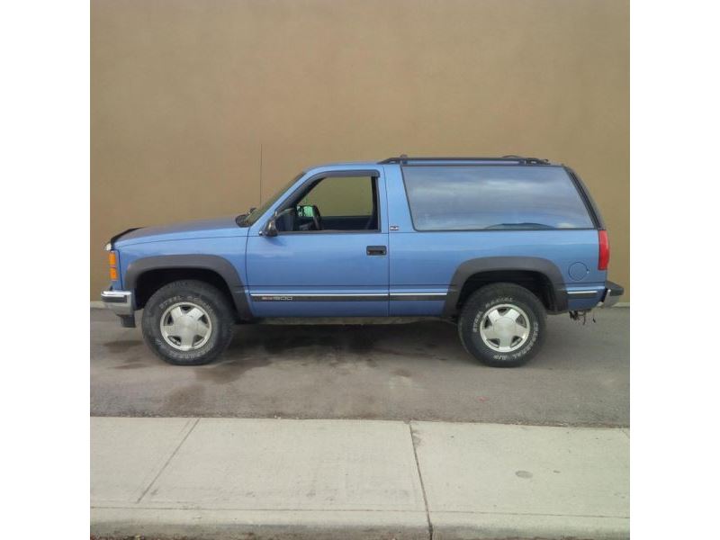

:driving: Hello from Calgary Alberta Canada. New to this forum, female owner of a 94 GMC Yukon SLE ( love my Baloo )
