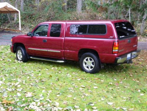

I put a SnugTop on my 2006 Sierra six years ago and I am very happy with it. Never has leaked here in the Pacific Northwe't. My truck had the factory tail gate plastic, which never did fit the tailgate very well, but it wasn't the spoiler type. I replaced it with after-market that was part of the bedrail cover kit, and I think it was Bushwacker, but I can't recall. It fits much better, and gives a perfect fit under the bottom shield of the SnugTop. The topper fits perfect over the bedrail caps.
pics below
