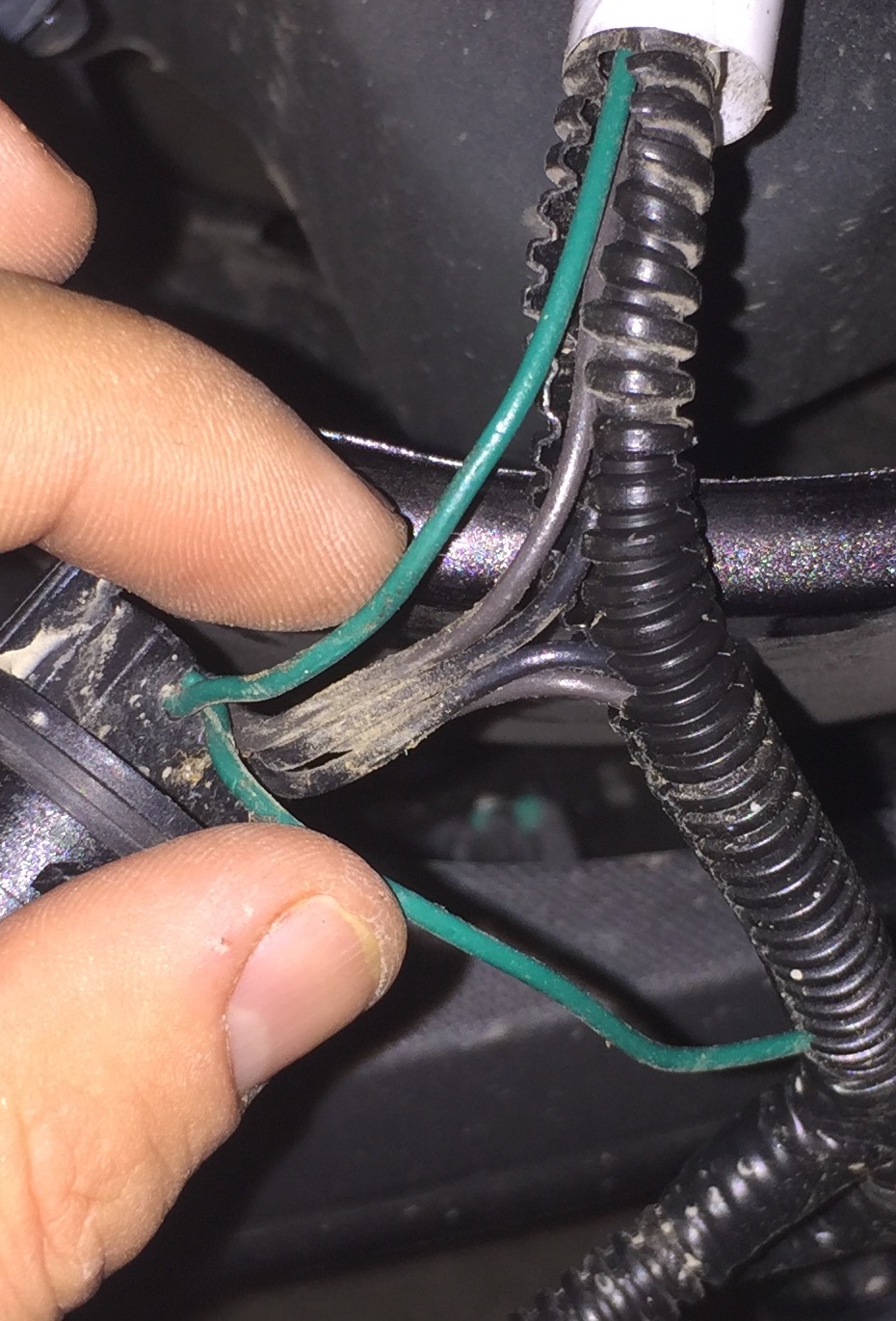

Quick question. I have resistors for each side in the back. Which wire. There is one green two black on the one bulb and 2 green two black on the other blinker. Here are reference.
What are you tapping into? Looks like the wires I tapped into for my reverse lights
yeah I tapped into the green and black wires. it was pretty easy to install. just make sure you put the resistors away from anything plastic. just make sure you put the resistor on the wires that are coming from each led and not tapping into the same wires that you already put a resistor on.
