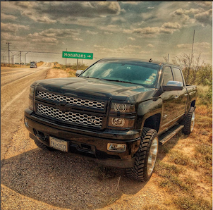

This weekend I finally got time to get all my new parts installed on the front of my 15. I'm still waiting to install the painted bowtie insert. It was late and the clear coat wasn't fully cured yet (I like to wait a week on front end parts. I will hopefully get that done next weekend.
Thoughts?

I have to say that I am not a fan of chevy due to the ugly front end (my opinion).......but this face lift you have done is BAD ASS!!!
Call Chevrolet and tell them they need you. :driving:

LOL...Thanks. I need to get the time to install the insert to finish it off. I will post some more pictures when I get the wheels on.

Looks awesome! This is what I am planning on doing, but will have to take it to a professional since I'll F it up for sure. Did you consider color matching the bumper? I saw this truck on Instagram and it looks awesome

Too many out there with painted bumpers and I wanted something different.
Looks great. I am doing something similar because I also wants to keep my bumper chrome. I thin I am going to do all my chrome except door handles, bumper, and rails.
I had my chrome pieces around the headlights painted, and installed a black grill surround on my hc (bumpers were already black) wish I installed some sort of chip gaurd, or clear bra, as the paint has chipped already.
