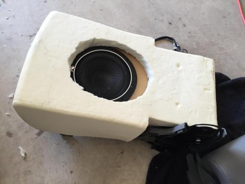

Well after trying all morning I couldn't design a box for the 12" that had the cubes I needed so I went back to using an 8, built a new box and then cut the seat cushion to fit around the box. Here are some more pics.
Fitting the box
Trimming the foam
Installed back in the truck
Its easy to arm chair quarterback, so please don't take this wrong. Wouldn't it have been better to have had the sub fire down instead of firing up, then hit the edges of the box with a router so that the seat "could" be used without damaging the sub?

I had initially planned on doing it down fire, in fact the box I took it out of was a down fire box I had built for my Tahoe. Then I removed the center console and saw an Airbag control module right underneath it and quickly decided that a downfire may not be the best idea in that spot.

How much volume did you end up getting out of that small space?
Right around .3 cu/ft, which is actually a smidge more than the recommended for that speaker. I calculated that I could get almost .8 cu/ft if I were to built a top box in the shape of the seat (Which I did), basically a bigger, although thinner, box on top of this box. It was still going to fall short of the 1.1 cu/ft I needed for a 12" sub. Would of been perfect for a 10" but I will say, if I turn the bass up the arm rest does start to rattle if I don't have my arm on it. I imagine it would be more of an issue with a 10" in that position. But for what I listen too this isn't an issue. Now for what my wife listens too the whole cab rattles.

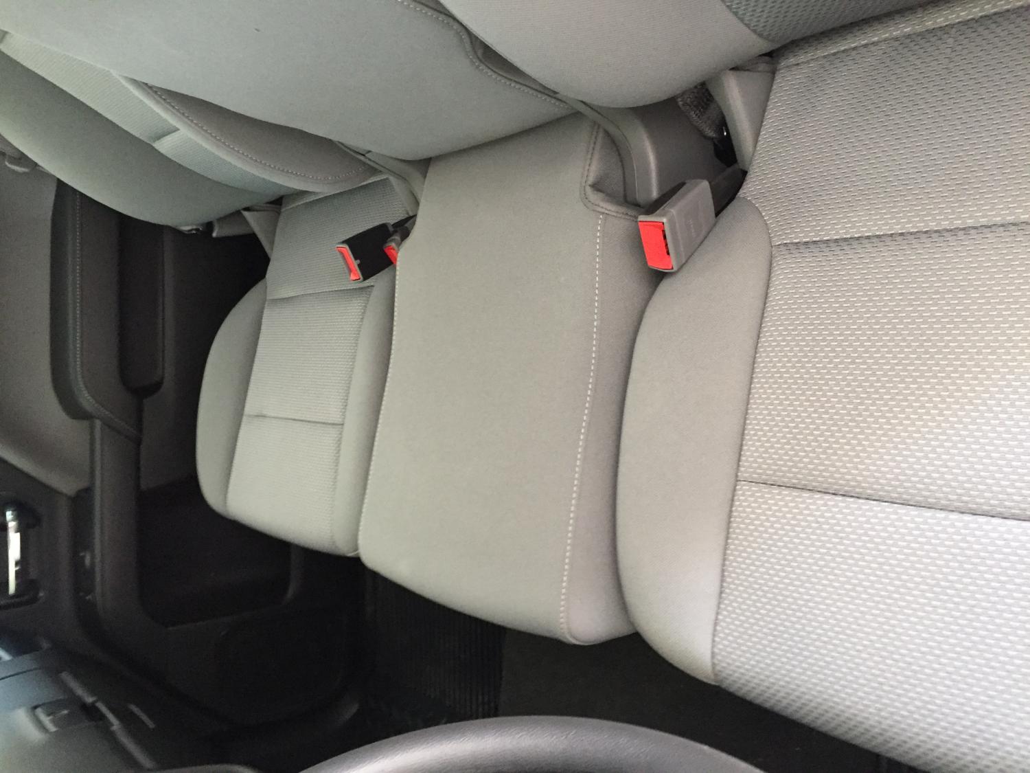

Fitting the box
Trimming the foam
Did your jump seat have the lockable storage compartment under the seat cushion? It doesn't look like it but just curious. I have a CC and mine does. I kind of want to do the same thing in mine, I also don't want to lose the storage space under the rear seat.
